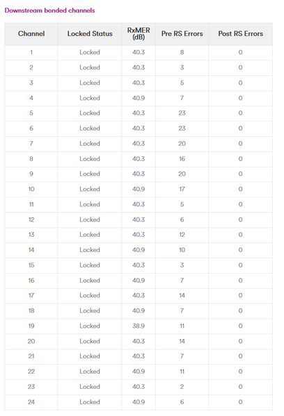

My new M125 connection uses Hub 3.0. The only thing on the line is a TRIS-102A 5-1000MHz (I assume this is a surge protector). I have not used the thin coax cable with a bulge in the middle (not sure what that is). The following are the line stats.

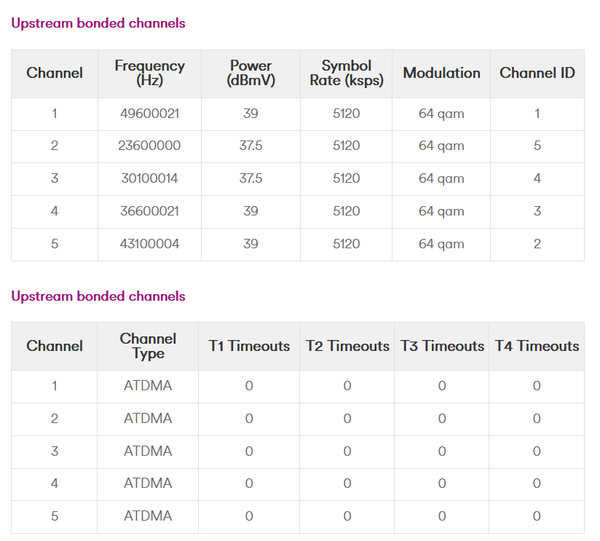

I have noticed that the upstream channel 5 fluctuates beteen 64 qam and 32 qam, which I believe indicates some noise on the line.
I would appreciate it if someone could explain if all these values are within their expected ranges.

  • Your downstream power levels should really be between -6 and +10, 0 being optimal.
    QAM on upstream fluctuating does indicate noise.

      Thank you for commenting, @carl_pearce How can this be achieved? I am guessing that an attenuator will be required.

        For the upstream power levels yes, an attenuator is required.
        The QAM fluctuating needs the attention of an engineer visit, or possibly local fault, which you can check for:

    You need a forward path attenuator fitted, only a VM technician can do this.

      An engineer arrived yesterday and installed a 10dB attenuator. He also gave me a 6dB one just in case the upstream signal gets too high, causing instability. With the 10dB attenuator, my DS signal is now at 2-4dBmV and the US signal is at 48.5dBmV. With the 6dB attenuator, the DS signal is around 6-7dBmV and the US is at 44.5dBmV. I am sticking with the 10dB attenuator.
      Everything is stable except for one of the US channels (channel 5 - 23.6MHz which is at 46.5dBmV and keeps switching between 32 and 64 qam). All other channels are stable. A quick scan on this community suggests that the 23.6MHz band is known to have some issues. I would appreciate further insights into whether this can be safely ignored or needs futher attention.
