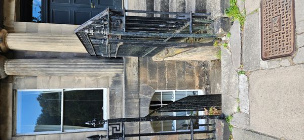

  • This is the CATV Grate outside my front window. You can see the basement window (can just make out the black cable running against the wall and then in through the basement window. The window above is on the ground floor and where I want another connection.
