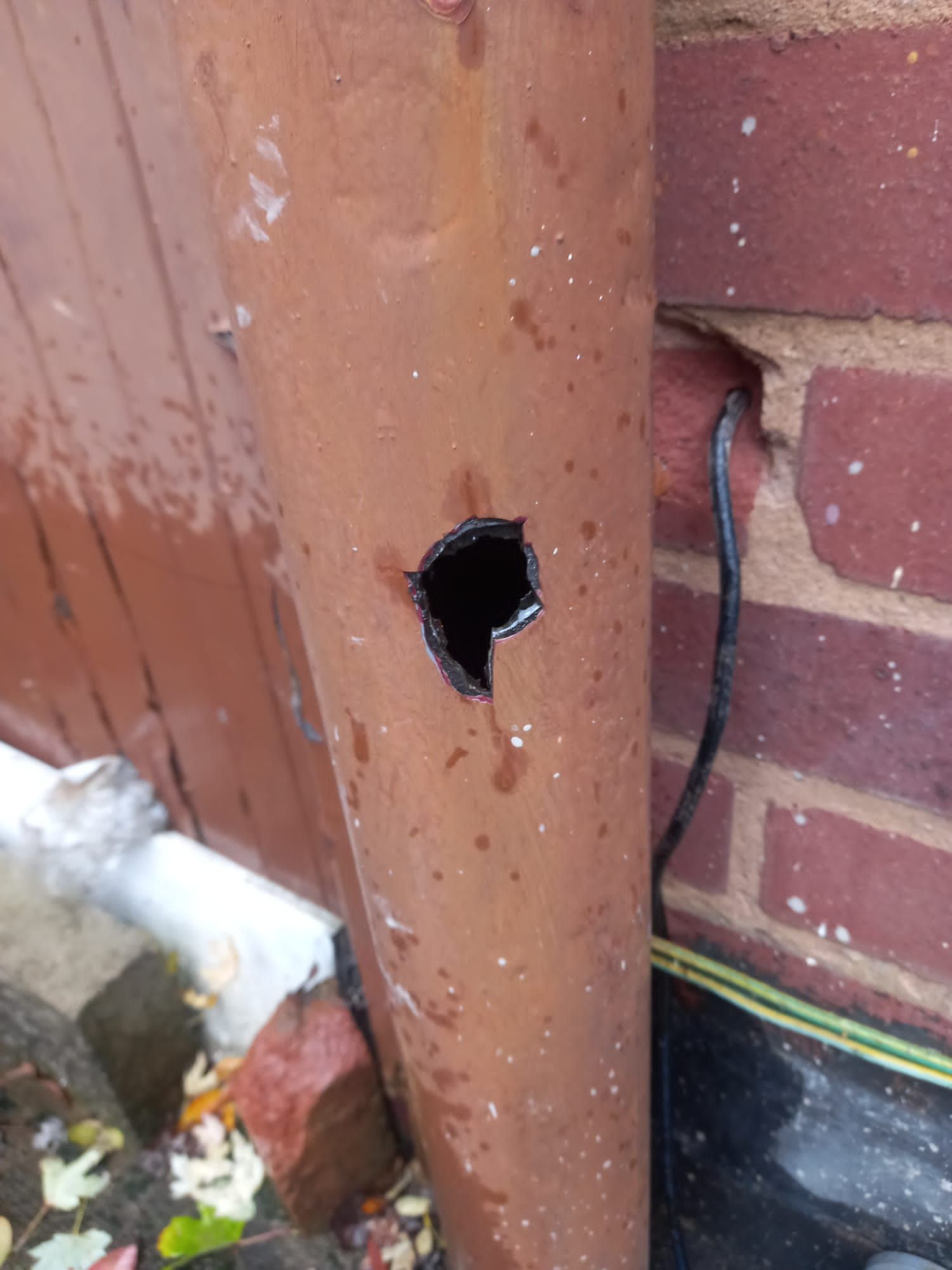

I had the engineers round on saturday to install my wifi but theyve accidently drilled through my toilet pipe that runs on the outside of the house from the upstairs toilet down to the sewers. Can i please get someone to fix this as the toilet is used by
my diabetic parents during the night .

    Your photo looks like a cast iron pipe which is probably not going to be that easy to repair/replace. My guess would be you'll need a temporary fix by way of a patch or bandage repair of some kind to begin with while you work out how to make a long term repair.
    If that is the VM cable in the background of the photo, they could also remedy that big brick blow-out at the same time!

    In the meantime, you'll need to get a suitable adhesive roofing strip from a DIY store, that you can wrap round the pipe to make a temporary repair. Then I'd suggest you get one or more quotations from builders for making a permanent repair, and submit them to VM's head office, saying that a Small Claims action will follow if they don't pay promptly.
    Edit to add:  It's likely that parts of the broken pipe may have fallen down inside, which could potentially cause a blockage. It will be necessary to investigate the sewer pipe down below for any parts of the cast iron.
