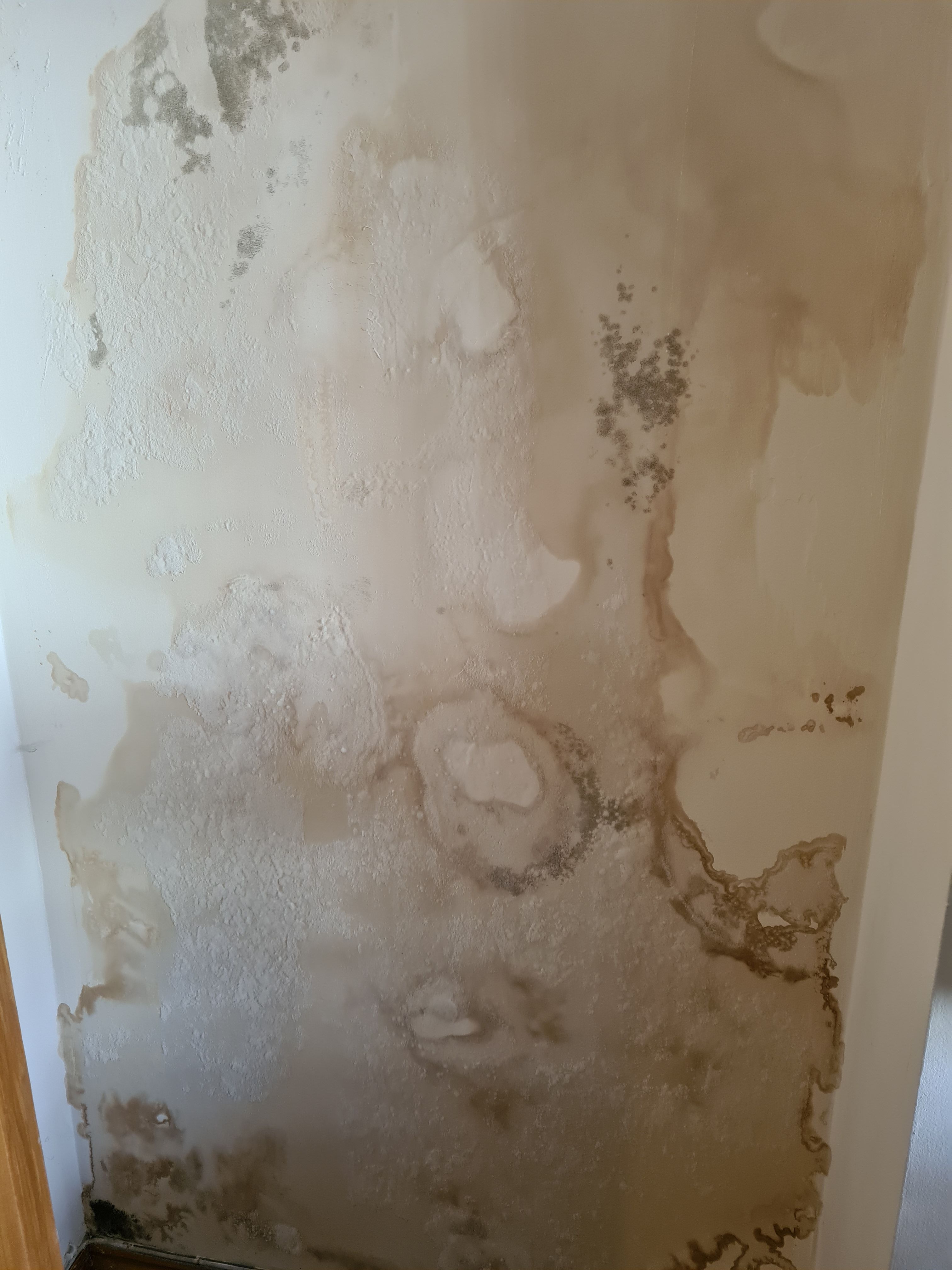

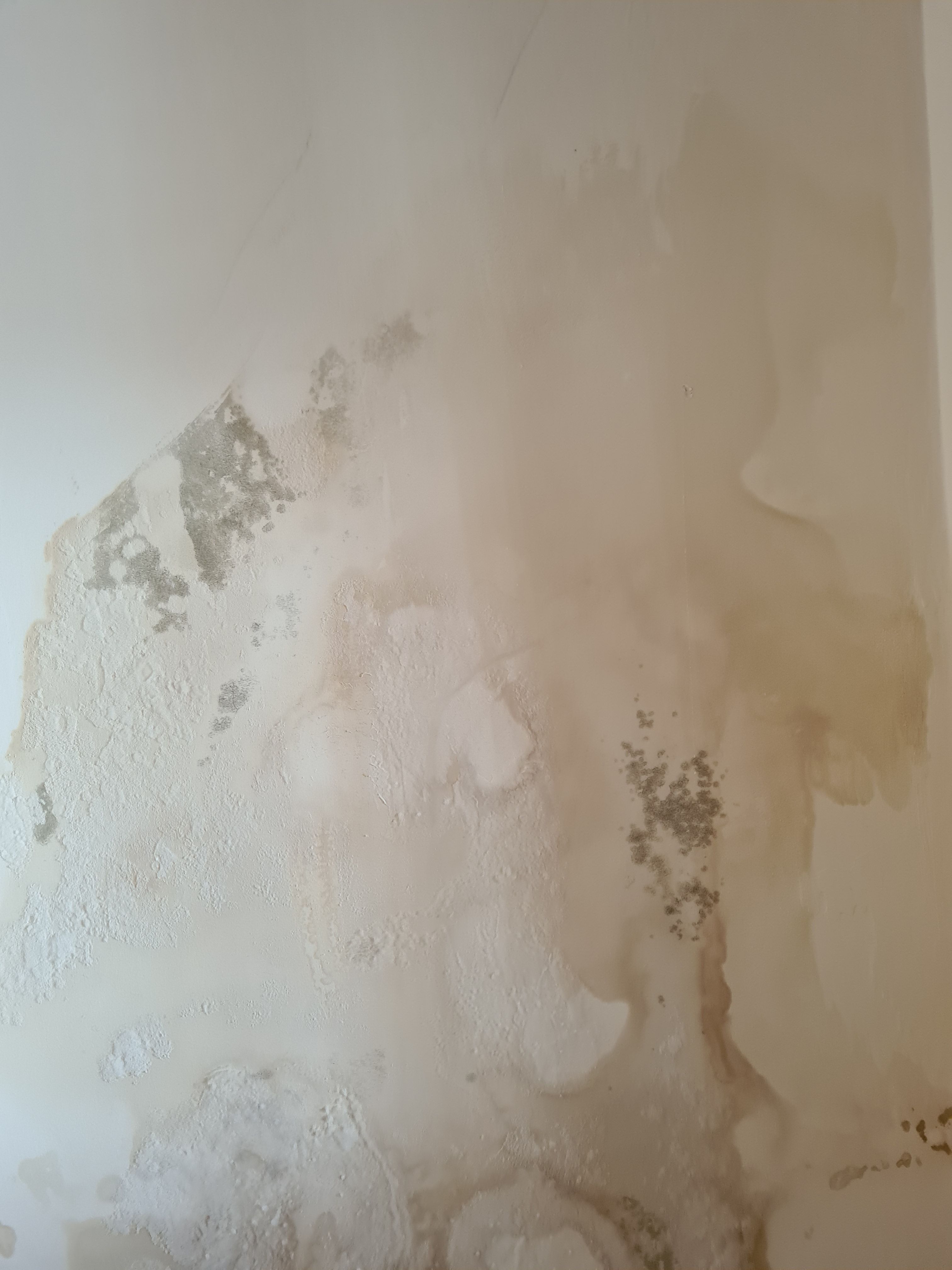

I am not a Virgin Media customer. So I do not have an account. I do however have a large CATV cabinet 5 inches away from our house wall. It is causing severe damp issues and despite a Virgin Media person visiting they have told me that it is not something they can help with! The damp has damaged furniture and we cannot even begin to try and repair it because the rain continually runs onto a wall that we cannot access to repair!

    You could post some images of the issue on here (both inside and out) showing the damage, and explain what you want doing about it, which may help the VM forum team when they get here.
    What advice have you received on what needs to be done to repair the wall/damp? Do you have a quote for the work describing what needs to be done with associated costs?
    Have you identified it is an issue above ground causing the problem (e.g. water penetrating damaged render) or an issue below ground (e.g drainage sort of issue etc.)
    You are likely to have to demonstrate a clear link that the cabinet is causing the damp issue to try and involve VM or take it further via something like a small claims court process.

        There is no other damp in the house only on the wall by the box!

    That's certainly a lot of damp but you haven't explained how/why the VM box is causing this.
    What is the construction of the wall outside? Some photos from outside might help.
    At first appearance those pic's look like water is possibly penetrating through the wall at a lower level (such as passing through a solid wall or single skin of brick or passing through damaged render) where the staining is more concentrated.

    If you take out legal protection as part of your house insurance, speak to that team. You are likely going to need a solicitor to write to VM's legal team. Before you do this, ensure that independent damp specialist says the cabinet is to blame, or that to fix the issue, access is required where the cabinet is that is blocking access. You have penetrating damp, and could be mortar that is weak and letting water in, but as you say, if you can't get access to the mortar to do remediation work then it's an issue, especially in terms of personal health with mould.

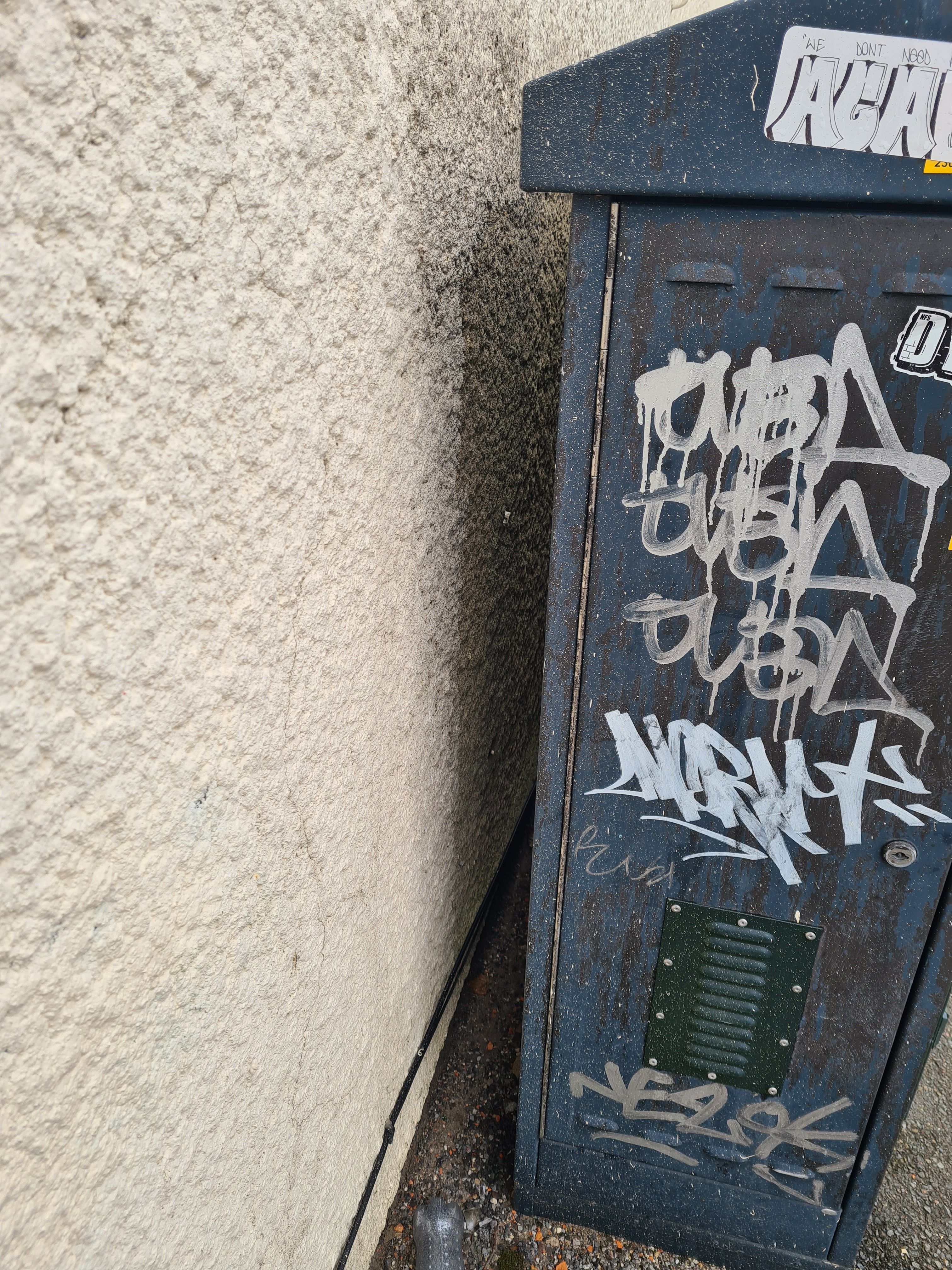

        It s a tough one because there is plenty of air flow behind the cabinet to dry out water and it water can escape from behind, unless that surface behind is cracked/damaged and absorbing water right at your foundations. It's hard to see from the photo. I also can't see if the sloped angle of the cabinet would direct water straight onto the render in a downpour, which in Winter time freezing weather could make the render worse if there are cracks where water can get in behind, although from the photo the render is not blown (yet).
        What I can see are cracks in your render; the slightest crack will allow water to get in behind the render. You really need to be sure before taking VM in respect of damp blame and recompense. However, the cabinet does obstruct fair maintenance of the render, and the building was likely to have been built there before the cabinet was implemented. I'd be arguing the latter by involving my house insurance legal team initially for their advice as it could eventually affect the fabric of the building. Again, you need to have caution and wait for trades people to state they could not complete work because of the cabinet.
        There is quite a few questions just from the photo 🙂

      The wall behind is not reachable and the rain runs off the box onto the wall. We have had builders look at the job but they all say the same thing..... they will not attempt to repair the wall because off the box!

    The description of the issue is easier to understand now with the outside photo. Presumably the angled top of the box is directing rain water backwards towards the base of the wall and onto the wall. Shading from the box will probably also hinder the sun from ever drying out the wall.
    Advice from @unisoft seems to be the best fit for the situation unless you get some help from the VM forum team when they eventually get here.
    I would say you have two problems to deal with. One is to get your damaged wall repaired. The other is to get the VM box changed or modified so the problem does not reoccur once you have the wall fixed.

    Slightly confused by the photos because they're a bit too much of a tight crop to get any idea of the context. In your first photo it looks like there's a doorway immediately to the right of the damp patch, which can't be possible based on the photo of the box.
    • Evielou25's avatar
      Evielou25
      No door, originally the house was two small rooms and has been changed to a large.  This happened many years ago before the box was located.

    It seems pretty clear that rain falling on the slope of the cabinet will run down either to the base of the wall or down the side of the wall, depending on the intensity of the rain and the direction of the wind.  That's inarguable.
