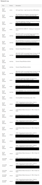

Speed issues - 1Gbps connection
Morning All
Looking for a VM support rep to check logs and possibly arrange engineer visit if required
I've been getting 250Mbps Max speed most of Jan
done countless re-boots
Network log reveals something isn't happy:
Network Log:
[MOD EDIT: Image containing sensitive info (CM MAC) removed. Please edit and repost]

      Checking the systems on our side we cannot see any issues within the area. We can see that our router is currently in modem mode, so we aren't able to run any further checks.
      Can you please pinhole reset our router to factory settings and remove the third-party router from the network? After this, whilst our hub is in router mode, please check Sam Knows real speed here, and let us know what results you get.

      You often get those ‘errors’ when the hub is rebooted and can be forgotten, they do not affect your service. Please post a full set of stats, details below:

  • Not really, that's very inconvenient to rip out my whole setup.
    The network Log shows Sync issues between the network - nothing on my side of the modem.

        Problem solved with a pinhole reset, 2 x power cycles and then placed back in modem mode.
        Odd, but typical in past experience
        still showing sync issues in network log but back up to ~800-1000Mbps
