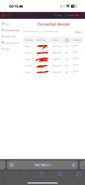

Ethernet Port 4 on the Hub 5 shows four different devices connected at the same time, which seems really odd. The connected devices list shows:
  • Multiple entries listed as “unknown” with different MAC/IP addresses
  • All of them showing as connected via Ethernet 4
  • Speeds are all showing as 1000 Mbps
However, despite showing this, nothing actually works on that port — the connection in my games room, which is run from that Ethernet line, gets no internet through the Hub 5 directly.

This tells me the wiring to the games room is fine and the devices are working — but for some reason, the Hub 5 isn’t handling multiple devices properly over that single Ethernet port, or it’s getting confused by the switch?

    The Hub 5 is reporting the speed of the first connected device for each network socket, so a Gigabit switch makes everything look like it is at 1000 to the Hub 5, even if it is a 10/100 printer or TV etc.

      Hub is in modem mode, however that particular Ethernet works in the Vigor switch but not from the back of the router.

        The HUB can't be in modem mode as the image you posted shows you are connected on 192.168.0.1.
        When in modem mode the HUB is accessible on 192.168.100.1.
