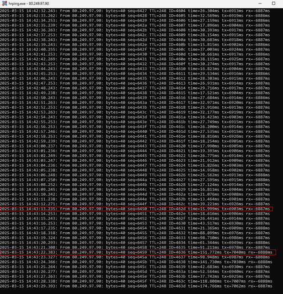

Started at at around 2pm not sure if its my side or VM but whats really odd is if I run StarTrinity CST with 1Mb problem goes away....so I'm I goes to have to run CST all the time to get good latency?
https://www.thinkbroadband.com/broadband/monitoring/quality/share/3920d137ef538aff3488a65d13a31520899a7470-15-03-2025
Then when I stopped CST it pinged high again as you can see by timestamp ping on the tx if you offset the times like this
15.999ms where tx shows 6903ms and rx -6887ms due to time drift so make as 16ms half each side 8ms by 8ms so tx off set is 6903 – 8 =  6895 and tx is 6887 + 8 = 6895
Then apply the off set to 151.772ms which is  7040 -  6895 = tx 145ms and  -6888 + 6895 = 7ms rx
whats anyone's take on this? I'm not ruling out it being my side but do you think VM could be messing with latency? Seems odd that a 1Mb stream that the latency is better then when my connection is idle?
And then to really fix it I just unplug the Ethernet for 2 mins without a reboot of hub and everything fixed.

  • legacy1's avatar
    legacy1
    One thing I did not test was ping to 192.168.100.1 so if it happen again I test that
    This would not be a Bufferbloat as my connection was idle there is another bit of hardware before it get to my QoS/BQM hardware so that would suggest its not my end. But maybe the ingress buffer on the hub was looping and that running a 1Mb CST some how made latency better? But a unplug making the port link down reset it?
