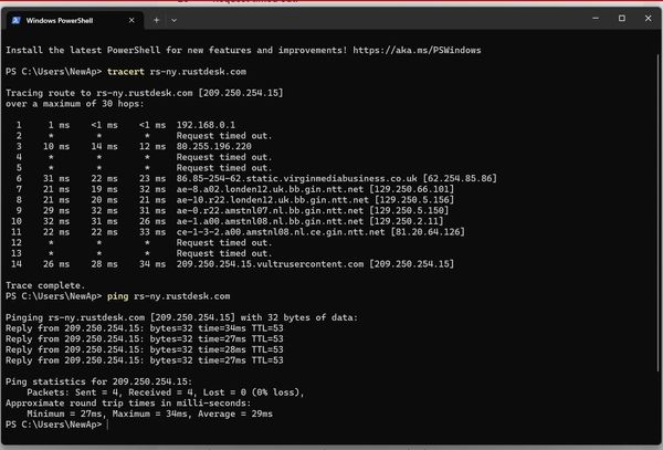

  • Hi Alessandro, yes must be a local issue then.
    As far as I can tell all other internet traffic seems OK (well nothing else that I regularly use has a problem).  Here is the trace route results.  Perhaps someone can use this info to fix the fault, I totally rely on Rustdesk to access all my computers in my home.
    thanks
    Duncan

    I can ping  rs-ny.rustdesk.com  via our VM connection in Colchester.
    Try a trace route to  rs-ny.rustdesk.com  it may expose a local routing problem.
