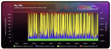

Can somebody check my BQM with Gig1
Hello, Would any of you experts like to check my BQM, please. I've been experiencing a fair bit of slow streaming and lag and the connection just generally feels a little sluggish. For the most part my house is hard wired with 2.5Gb ethernet but obviously not every device supports that. Recently my neighbour has had VM installed and they have tapped off our external brown plastic box, I questioned them and they said it would be temporary and somebody else would come to install another line but this has not happened. Well, to the best of my knowledge anyway. https://www.thinkbroadband.com/broadband/monitoring/quality/share/fc9fbfedde634eb01e057d7969f183729c300fe9 I can share logs from my hub but I'm not sure what is required.228Views0likes11CommentsBQM Check for Gig1 please
