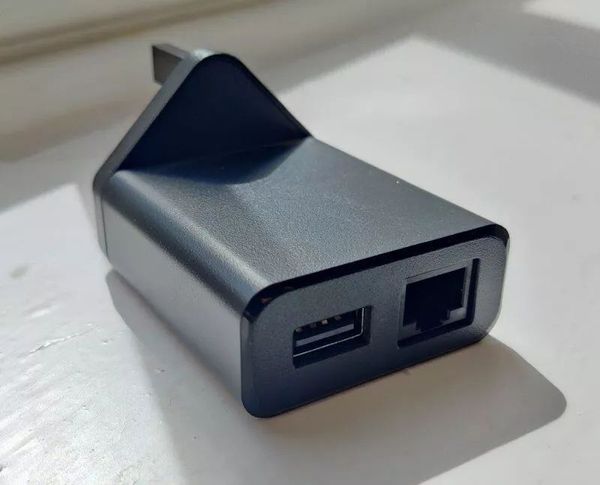

    How is the Stream box actually connected to the internet?  It's best if you can use an ethernet connection (the ethernet connects via the dual Stream ethernet- power adaptor - see picture below)  If you are using an ethernet cable then maje sure it hasn't loose at either end, or try a different ethernet cable.
