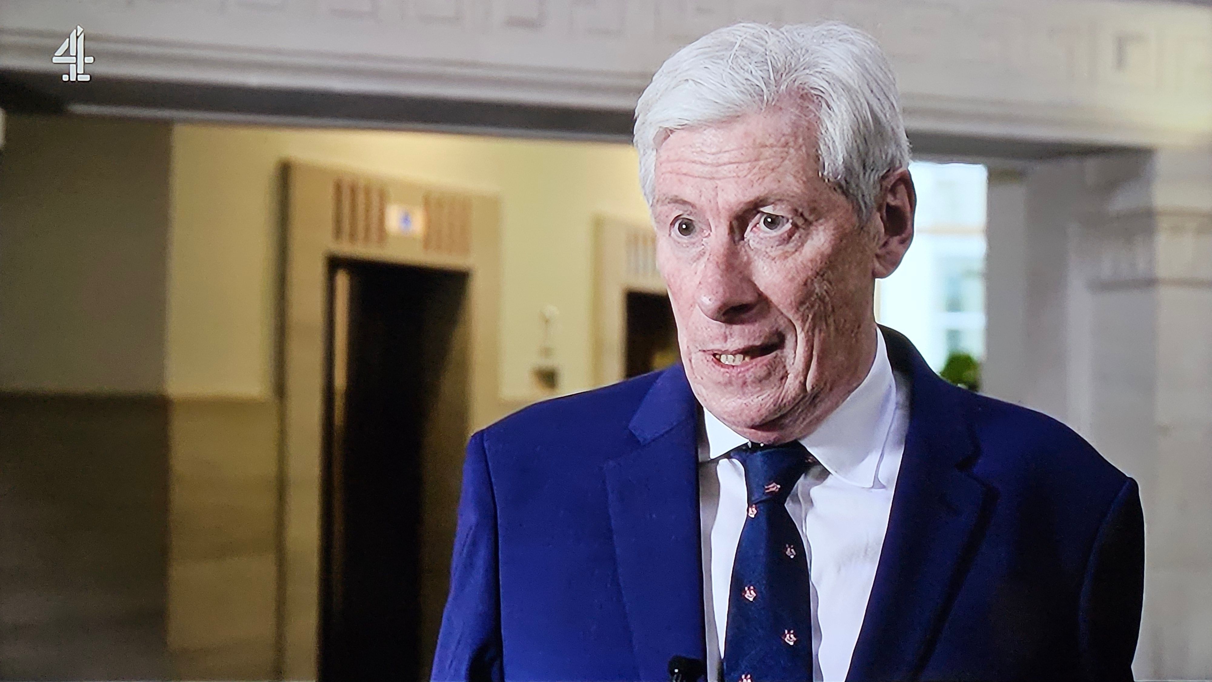

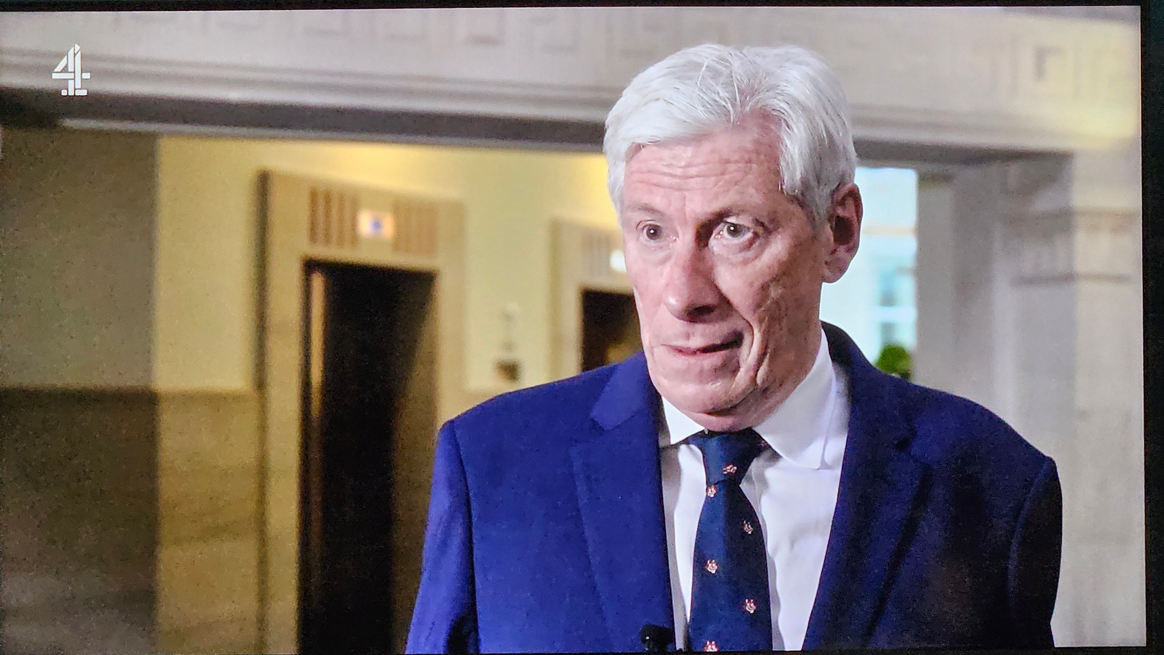

OK, so the stream puck arrived. It's like going back ten years in terms of quality.
Unless I'm mistaken, there's no way to watch from start unless it's BBC which jumps to the iPlayer, or itv channels that go to itv X. On sky stream when you select a channel you can always press a button to watch ANY PROGRAMME from start from sky's servers.
The picture quality is truly appalling. How you can call this HD I have no idea!
Attached are two photos from channel 4 news. Even at the low resolution this forum uploads, you can see the sky stream picture is pin sharp, but virgin stream is barely focused and far darker. I got those to get sky sports cheaper, but I'm loathe to give virgin a penny more if the quality is so awful
 I'm very tech savvy, so please don't @ me will comments about trying different cables or whatever. The tv thinks it's receiving a uhd picture at 3840x2160, so the quality issue is clearly Virgin's.

  • Try changing the VM box settings so it outputs at the video resolution of the TV program, rather than doing the upscaling.   The TV & Sky box could have more CPU for doing the upscale, but who knows !!.
      The Sky Stream hardware is pathetic and slower than VMs in every way. Whether its optimisation of code/build or the actual hardware; real life use of navigation and loading apps is slower on current hardware generation of Sky Stream.
      If you have a decent TV let the TV do the deinterlace and upscale and set box to 1080i. That should normally look better than letting the box upscale (same on Sky Stream).

    I've had BOTH platforms together until recently. Although there are a couple of usability issues on VM's Stream, in my opinion its vastly superior every other way to Sky Stream (up to 1080). The picture quality is superior to Sky Stream for a start on SD and HD channels (I did not say 4K content/channels). Even QVC and Challenge TV are encoded correctly and not simple 1080i50 to 1080p25 as done on Sky's service.

        • Most of the SD channels on VM Stream are HD ones too with higher at a higher bit rate. The picture really is quite decent on VM Stream, I definitely found it to be better than Sky Stream on SD and HD. VM do not decode and recode an off air picture from aerial or satellite likes years ago for set top boxes, they have direct feeds from broadcasters now at higher bit rates than goes out on Transmitter MUXs.

    You can set the box to 1080i which will pass through HD but you'll need to reset to 2160p for UHD - which might be a hassle.
  • For the Video resolution question, look up how Mpeg Dash actually works.   There are multiple copies of each TV channel, but at different resolution & bitrates.  Only one rate is used at a given time, depending on the network connection (primarily your router to stb WiFi).   If the bandwidth from the Router to STB drops, then the STB will switch to a lower resolution in order to maintain the vdieo & audio.   Clearly this will be more predominate on WiFi, and also depends on the distance from the router to the STB.
    As said above if you set the STB to follow the stream resolution you will then see the TV switch as the streams change.   Note: this will be annoying on some TV's, so only do it as a test.
    Lastly, when changing channels the STB will probably start with the lowest resolution.  Wait a bit for the streaming to switch to the higher rates.  I don't know what chunk size VM uses, but it could be anything from 2-10 seconds, whci means it could take 30seconds to get to full resolution (assuming your WiFi can support it).
    If possible, try the same tests using Ethernet from the router to STB.
