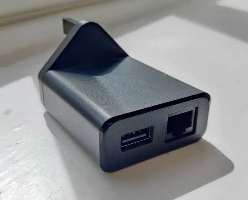

    I'm not able to do a hard reset because it requires an ethernet connection but I see no ethernet port on the box, what's that all about?
    Hi again JimDeadlock
    You should check ther equipment that VM have sent with the Stream box. The Stream power adapter includes the ethernet port, picture below.
    Stream power plug incorporating ethernet adapter

    Thanks for the reply. I did the soft reset and I was encouraged when it allowed me to go through the setup process. I connected the remote, did the region and wifi settings and it seemed fine, then it did an auto software update which sent me back to the white static. I tried a standalone software update, same result. I'm not able to do a hard reset because it requires an ethernet connection but I see no ethernet port on the box, what's that all about?
