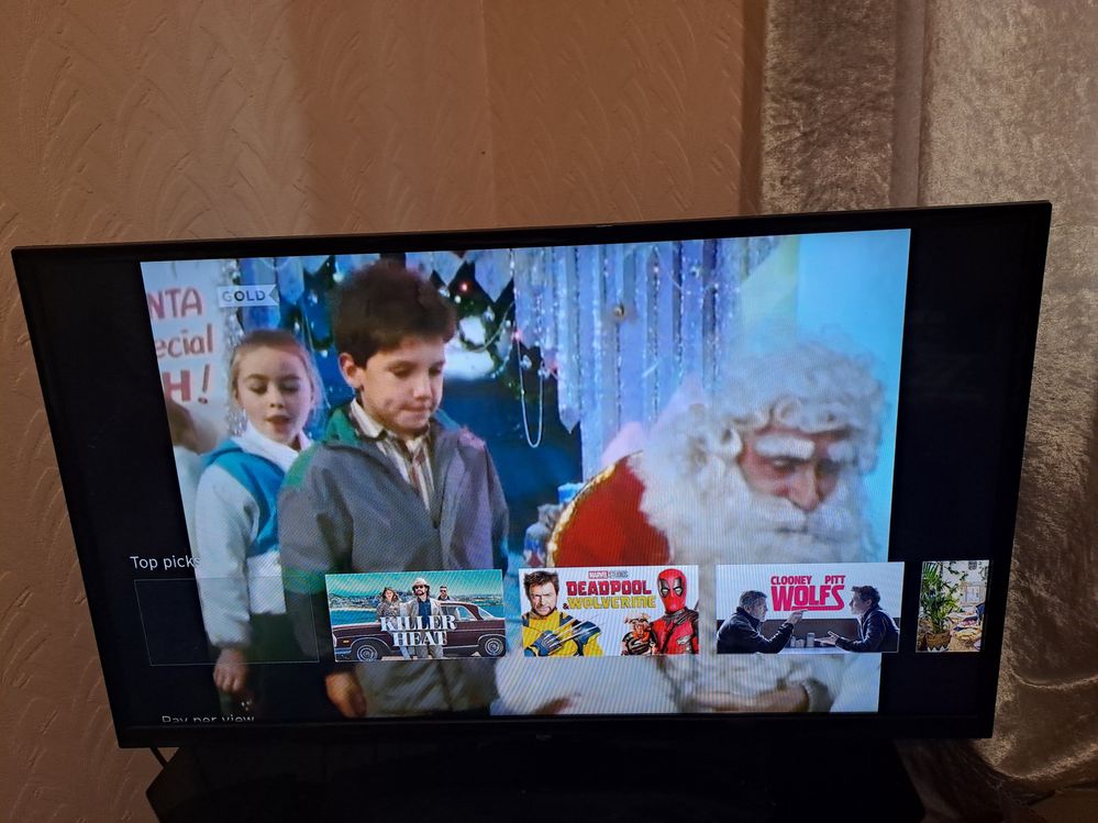

Problems with top pics on my TV
They don’t appear to have a clue about technical stuff. I am trying to watch a TV program with Top pics and pictures across the screen. I can’t remove them. When I try to get technical help over the phone I get,If you require technical help press 2, TV not working press 2
We will send you a text where you can find answers on line. Good by.
I said next time thinking of leaving in order to force a person on the phone.
I told him that when I switch on the TV,  get a TV program with a Top picks and pictures of programs across th TV
He replies with things like, We will send an engineer out, We will send you a replacement box
He asked me do you seeing an x on the TV
I said to him what do you see an X when you watch TV on your screen. He replies with , I don’t watch TV. People working for VM don't watch TV.
Cant find a way on here for atachments so...
(http://desmond-otoole.co.uk/TopPicks.jpg)

      Looking at the picture showing the program from the Gold channel, the problem is that the 'Top Picks' rail is superimposed over the actual TV picture.
      Does this happen on all channels, or just on Gold?
      Does this only occur when you've just turned on the set top box, and then disappear when you change channels, or when it's been on a while?
      Have you tried switching the Stream box off at the mains for a minute or two rather than just rebooting the box?
      Have you tried either removing and then reinserting the HDMI cable, or a different HDMI cable/port?
      You could try performing a soft reset and/or a hard reset.
      Unplug the USB from the back of the box and then hold the power button on the front of the box while  plugging the USB back in. (Keep hold of the power button while doing this)
      Keep holding the power button in when the Welcome screen appears for 5 seconds and then let go.
      A menu will appear. Now tap the power button to select which reset option (hard or soft) you prefer. I would try the soft reset option first, and if that fails try the hard reset.
      Then hold the power button again for 5 seconds on the one selected option to reset it.
      Hopefully the box will then reboot without the 'Top Picks' rail being superimposed over the actual TV picture
