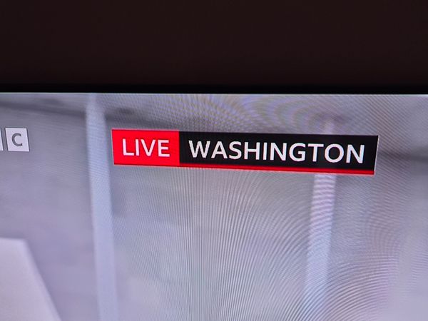

      Have to chime in on this as having same issue...Recently changed v360 box to flex box...All seemed fine at first now BBC seems low res compared to the other channels...
      BBC feed fine when using iplayer though...
      I csn only assume some sort of optimization fault with BBC feed this point....
      Images to illustrate both TV feed & iplayer feed...

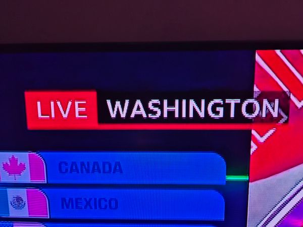

      Zoom in on the word Washington, first image is iplayer and nice crisp image...2nd image normal feed/channel 101 looks awful & this is like this with whole picture....
      Would like to know if a fix is immenent either via forthcoming update ?...

      Same BBC only
      First imsge channel 101 second image iplayer...
      Low res on 101 virgin flex box which i had recently swapped out from v360...
      Only seems to be BBC channels showing this fault BBC 4 also shows this image issue...
