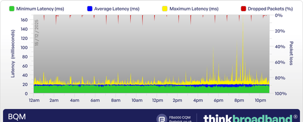

Regular Packet Loss Causing Disconnects
Since 1st November I have seen regular spikes of packet loss, initially small and not causing any increased latency or disconnects Progressively this has worsened to the point that the packet loss spikes are virtually on the hour, every hour and are far more noticeable whilst gaming. These spikes coincide with disconnects from World of Warcraft on two different desktop PC's.
Above is for 16th December as 17th I turned "allow ping from WAN" off via my Flint 2 router to test as I have heard of regular timed tests (Samknows) causing issues for others. This hasn't fixed my issue.
The issue persists via modem mode into a Flint 2 router as well as via the router mode on the modem itself. Impacted desktops are wired but I haven't tested wireless as I am confident this issue will persist.
I'll drop the logs in a reply below.

        Below is as of today and it has been worse over the weekend just gone.
        I'll switch into router mode at some point this afternoon as you've requested but, as already mentioned, it does persist through both modes.
        Does the input that legacy1 has kindly shared identify anything?

      likely a bad connection outside its always hard to know if its downstream or upstream likely is upstream the modem thinking the line is fine sends a packet which the other end of the CMTS Docsis can't work out then Docsis tries a lower Modulation for a bit then does some tests which gives the all clear for higher Modulation then the issue happens again.
      So VM should see a log of your modem doing this.
