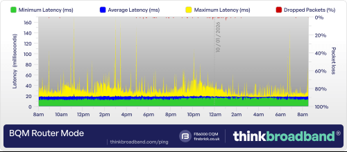

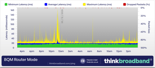

Regular Packet Loss Causing Disconnects
Since 1st November I have seen regular spikes of packet loss, initially small and not causing any increased latency or disconnects Progressively this has worsened to the point that the packet loss spikes are virtually on the hour, every hour and are far more noticeable whilst gaming. These spikes coincide with disconnects from World of Warcraft on two different desktop PC's.
Above is for 16th December as 17th I turned "allow ping from WAN" off via my Flint 2 router to test as I have heard of regular timed tests (Samknows) causing issues for others. This hasn't fixed my issue.
The issue persists via modem mode into a Flint 2 router as well as via the router mode on the modem itself. Impacted desktops are wired but I haven't tested wireless as I am confident this issue will persist.
I'll drop the logs in a reply below.

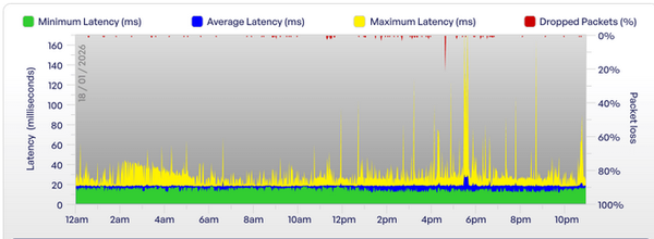

  • Just to bump this.
    The connection has improved a little since switched to router mode, but is likely a coincidence rather than indicating an issue with my 3rd party router.
    There was a bit of what looked like local utilisation issues due to Christmas which has susbsided for now but the packet loss is still present and, whilst not spiking and causing disconnects as often, it is clearly become more frequent rather than consistent intervals.

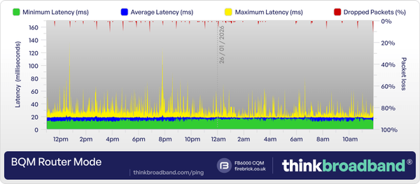

  • Still no improvement. The frequency of disconnects are increasing again and are most notable during peak hours. You'll have no issues and then you will have 5-10mins of high latency with disconnects. More severe latency/disconnects coincide with the packet lost spikes.
    I am still in modem mode, the 2 affected devices are both wired, have replaced all ethernet cables and swapped out the coax for another VM spare I had.

        Below is as of today and it has been worse over the weekend just gone.
        I'll switch into router mode at some point this afternoon as you've requested but, as already mentioned, it does persist through both modes.
        Does the input that legacy1 has kindly shared identify anything?
