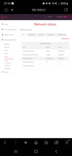

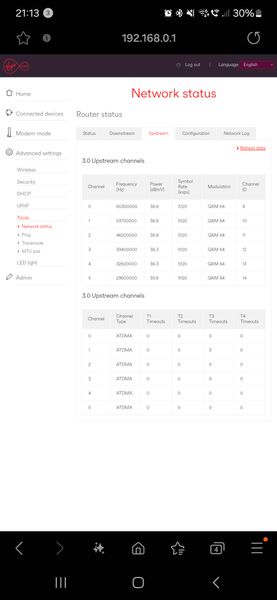

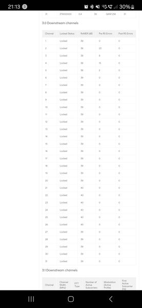

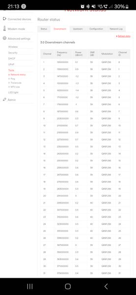

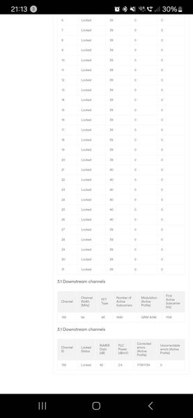

I have screen shots of my power levels to the hub 5 which I will attach below if someone could kindly take a look at them as I don't really know what I'm looking for.

    Seems odd you would have a upstream problem if your the only one on the upstream going from fibre to Coax?

      Do my upstream levels look not quite right?  Just wondering what you mean in your reply

    Setup a BQM as well. http://www.thinkbroadband.com/ping and post the shared live graph.  Post the most recent Hub power levels and network log.
