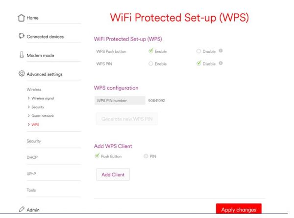

    You haven't indicated which actual Samsung phone or TV device model you have so we can offer specific advice, rather than the general advice shown below.
    Have you tried connecting by using the WPS button on the hub 3 and using the WPS function on your TV?  (and the same on your Samsung Galaxy phone)
    A short press on the WPS button on the front of the  hub 3 (above the red infinity symbol) will show the status lights. You need to hold it down until the WiFi light starts flashing. Then go to the TV's network settings and find the option named Connect via WPS or similar and follow the onscreen instructions.
    On the hub 3 WPS is normally set up by default if you have Wi-Fi switched on.
    If you find it’s not working, first access the hubs settings by  typing 192.168.0.1 in a browser window and enter the hubs settings password in the box shown on the screen  (that password is on a sticker on the base of the router. Make sure you’re looking for the ‘settings password’ not the ‘Wi-Fi password’).
    Once you’re in then click on Advanced, then Wireless, then WPS
    Make sure there is a tick next to Enabled, and also next to Push button under Add WPS client  as shown below and click on Apply Changes.
     (You can add an 8 digit pin number as well, although that isn't absolutely necessary it does offer extra protection.)
