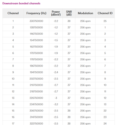

I keep getting various issues with VM, when I call them they say everything is fine and refuse to send technician
1) Internet keeps dropping
2) Zoom connection says unstable
I had SNR problems in the past and technician came and adjusted them.  Do I need another adjustment?
Screenshot attached, thank you!

    Those numbers are ok - but only a partial set.
    Can we check… are your issues only evident on wifi connections or do you see them at the same times on devices connected on ethernet cables? If you don't know, can you check on one to help diagnose whether it is just a wifi issue or it could be network connection/Hub related?
    What Hub model is it? What are the various Hub lights showing/doing when this happens if a Hub3 is the base light a steady white(ish) or flashing green?

      only use wifi so problems were on wifi but now after factory reset the wireless stopped working all together

        To confirm, is the WiFi still not working? Also do you have a device you can test on a Wired connection?

    Use your hub in modem mode and get your own wifi router with 1Gb ports
