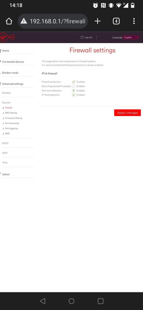

    You need to post the power level figures and network log so users can comment.  As for the BQM you need to allow your router to respond to pings.  At the moment it's just showing a block of red.
    To get the log and power levels, you don't need to log into the Hub.  There is a link called Router Status.  All the information is there.  From memory the respond to ping (ICMP) is in the Firewall section?
