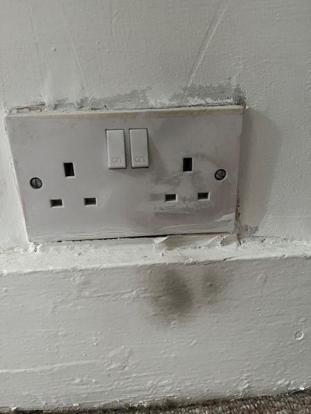

Hi, we've had our booster for a few months now and after taking out the plug the other day, we have noticed that it has left a black residue on the socket and wall, so obviously we have stopped using it.
After looking at other posts regarding this, I can see that this is a common occurrence, which is absolutely mind-blowing as to why Virgin would still send these out to people knowing that this could happen.
In any case, I'm hoping someone from Virgin can help us here with next steps. We have the boosters in here as the Wi-Fi has difficulty reaching our upstairs rooms, so we need an alternative, just preferably not one that will set the house on fire whilst we're out.
Furthermore, for those who have had this problem before, what was the end result once all was sorted, I envisage we're going to have to look into an electrician to check all is safe with the socket itself. I think the wall will be okay as it seems to be smoke residue but still not ideal.
Pics attached for reference.

    Thats a pod not a booster.  It was the old boosters that had this problem - not seen many pods reported as such.  As you say you should check the wiring in that plug socket.
    You would be best placed to call it in as a fault as VM can take a few days to respond here.  They will probably just send another as replacement.

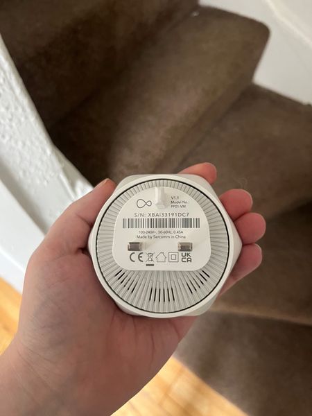

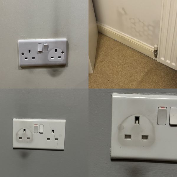

    I have noted an increasing number of reports on this forum covering the thermal failure of White VM Pods.  Including reports just like this where thermal and / or smoke damage has occurred to the wall socket or to the customers décor.
    I'm wondering if that is overheating, as the Pod looks to be unmarked.  The wall however IMHO is covered in dust from the fan points on the back of the Pod?  Could be completely wrong however

    Check out the wiring at the back of the socket, that’s possibly the cause as the pod itself does not look burnt. Bad wiring at the back of the socket is not detected unless you have a RCD.
  • I think it’s certainly an issue with the pod as we have an extension cable plugged in and there is no burn out on the left hand side. Going to call up VM today to see what options we have but I’m apprehensive about getting a replacement as it seems to be a recurring issue for a lot of people

  • Good evening — it is definitely the WiFi pods that caused it. We live in a new build and have plenty of other things plugged in with no issues whatsoever.

    Two engineers have been out, both agreed it came from the pods, and all photos have been taken and logged. One pod had only been replaced a few weeks earlier, but they get very hot — thank God we spotted it when we did!
