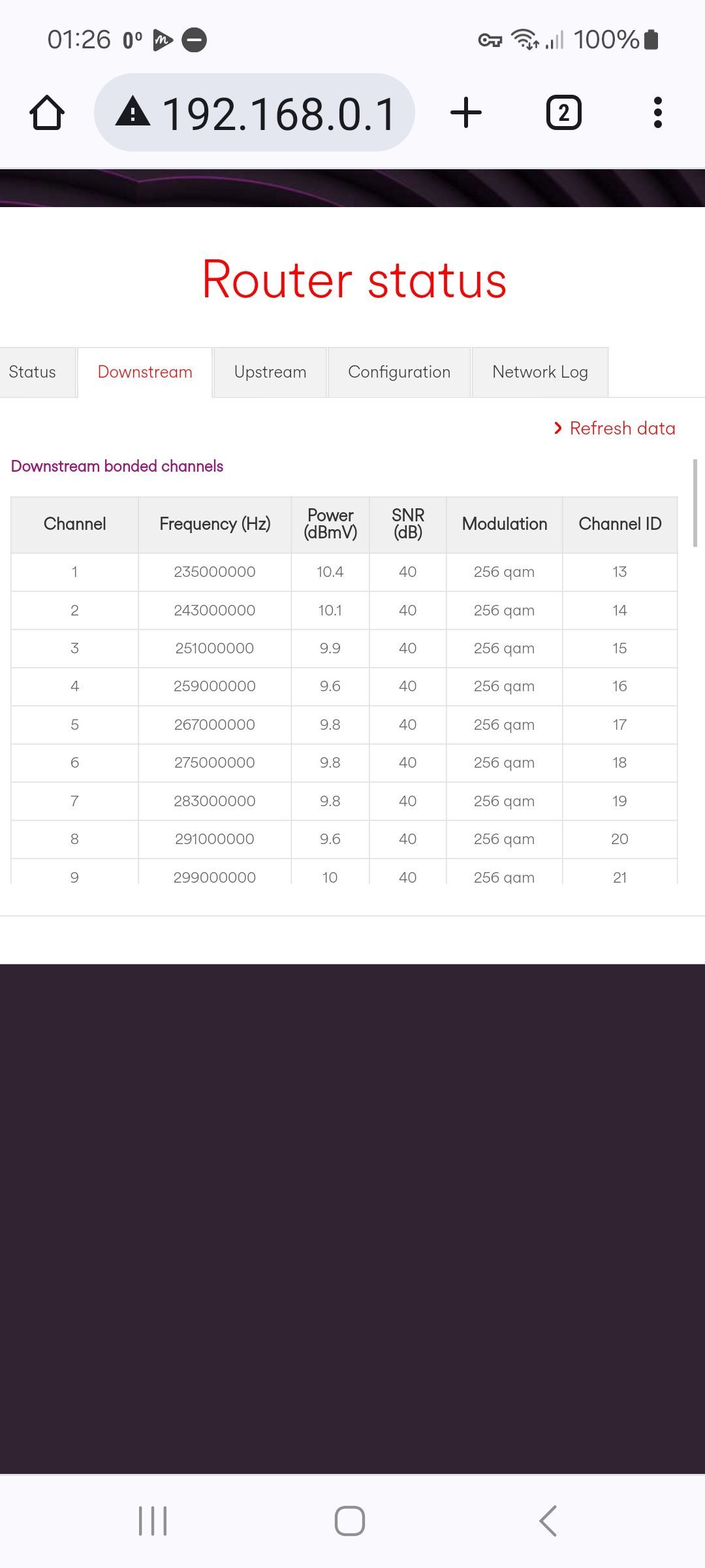

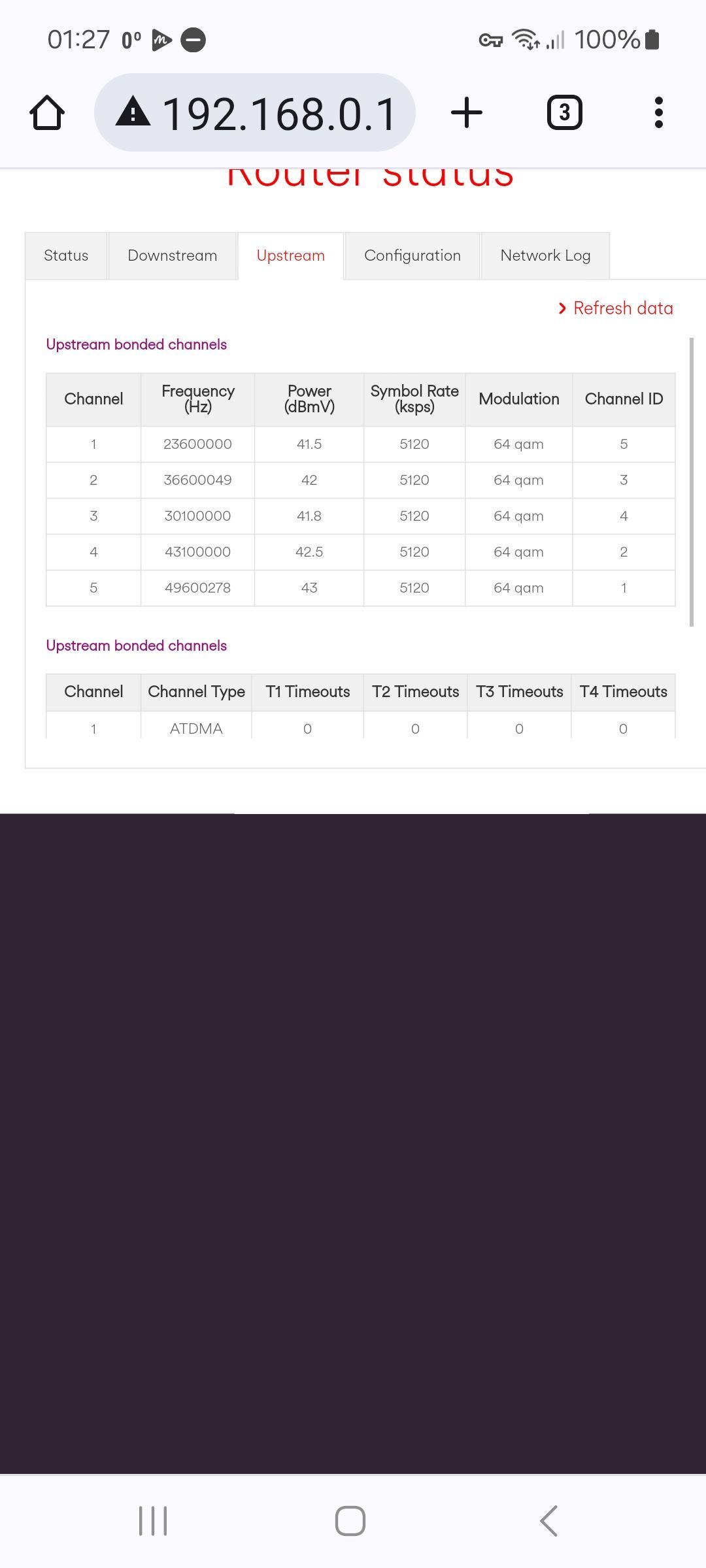

    • lilacjc's avatar
      lilacjc
      Not sure if this is the information you wanted but hope it is.
      Also the only ethernet connection is my Tivo box.
      Sorry if I have given the wrong information but I find all this technical stuff confusing.
      Thank you for your help
      • jbrennand's avatar
        jbrennand
        Cant read it... as I said above.... "just copy/paste the normal “Formatted Text”
