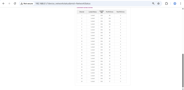

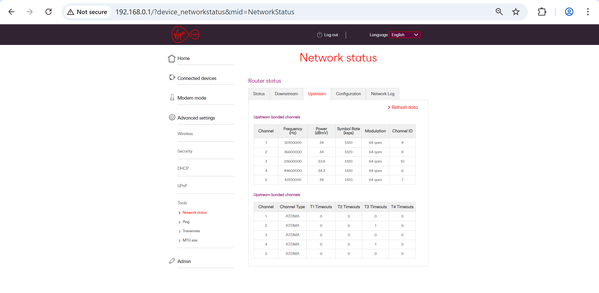

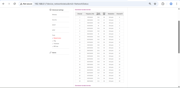

what kind of attenuator needed with high downstreama nd about normal upstream
anyhelp is appriciated; Hub3 is on modem and I have a mesh system Deco.The Hub3 was replaced 2 months ago and the outside cable was repalced as well after engineer visit.since then the internet drops out everyday for a couple of minutes or sometimes the hub needs to restart.last week switched to router mode to see if there is any improvment but nothing happen. I saw that the downstream is high in value which is between 18-20 dbmv. I think this the issue.called virgin to ask them to send me a 10db attenuator but isntead they compinsated me and told me that I can buy myself.I had an 8db attenuator at home , so after trying it , the downstream values went down by to around 11-14dbmv but at the same time upstream went down to around 34 from 37 before putting the attenuator. and after removing it the downstream went back high but the upstream stayed low. the question is what attenuator shpould I buy and where from and does it matter a specific brand or any brand like from amazon ?I`d appreciate it if you send me a link. please see the attachments when putting the attenuator and after removing it.
with 8db attenuator:
after removing the 8db:
thanks for your help
