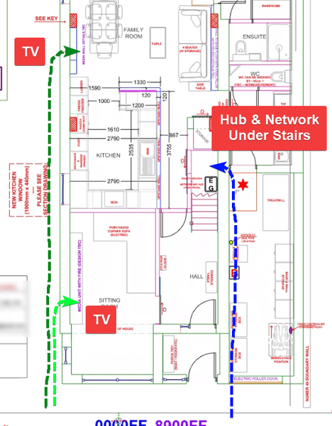

  • Hi all,
    I'm doing a renovation and am confused about how to go about looking into the future in order to get VM in the house.
    The below image shows the electrical plan I've made.
    My intention is to have the router/networking hub under the stairs (purple triangle) and a VM TV box in the sitting room and family room (blue squares).
    The work is still under way - internal walls for example aren't even up.
    I will be using WiFi meshes, an ethernet hub & the router will be put into modem mode.
    My questions are:
    1. Should holes be drilled in the external walls in preparation for the TV boxes?
    2. If so, will these holes definitely be used by VM?
    3. Is there a VM department where I can talk to someone about the plans and my intentions?
    4. How would I go about having the router put under the stairs (I want the cabling to be as un-noticeable as possible) ?
    5. I'm not sure whether I should use coaxial ports for the TV boxes - are these needed?
    In the family room I intend to have a media wall and the TV going over a recess.
    The TV box won't be on show - I'm concerned that by doing this we're not going to be able to use the VM box or it'll be dodgy/temperamental.
    If anyone can help with the above that'd be great.
    Sean

    Can you get cable under the floor? In which case the cable could go on the left hand side of your picture and across to under the stairs. VM will not put cable under the floor unless you laid trunking for it with a draw cord. I take it you are in a DOCSIS area, if it’s fibre then the TVs will only need Ethernet connections or could use WiFi, but not recommended.

      I would politely suggest you are unlikely to get too much more useful information via anyone from VM coming out to you. VM won't design a home network for you.
      We have also seen past topics on here where the customer has gone to the trouble of arranging a pre-installation visit with VM to address external cable routes, only to find that the external contractor has ignored all previous discussions and just crashed on with the fastest/easiest route to run in an external cable.
      If you are still at the first fix stage, you aim should be to fit as much cable containment as you can anywhere and everywhere that you think you may need connectivity. Materials to do this (such as flexible conduit) are not expensive.
      There is a huge amount of info in this topic already on what you need to do and, if you want info on cable layouts which VM uses, there is a whole load of that sort of info in the VM new build handbook
      https://prod.ctassets.virginmedia.com/uploads/new_build_handbook_v1_64_be936f5e4b.pdf
      If you were going to pay anyone some money for design, you might be best spending your money on a local supplier with networking and comm's expertise who could specify some suitable equipment for you to fit in with your overall design.
