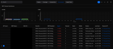

I'm hoping someone can help me in optimising my WiFi speed as I'm at a loss as to why my Hub 5 is able to produce better WiFi speeds than my full ubquiti set up.
My current setup has my VM Hub5 in modem only mode feeding my UDM Pro (from the 2.5G port on the hub) with the WAN connection - wired I'm getting the full Gig1 connection speeds so no problem there. From the UDM Pro then have my switch (USW-Pro-48-POE) connect via SFP which is then powering 2 access points in my home - U6 Pro and a Nano HD.
My access point settings are as follows...
2.4GHz
  • Channel Width: 20
  • Channel: 13
  • Transmit Power: Auto
5GHz
  • Channel Width: 80
  • Channel: 157
  • Meshing: Off
  • Band Steering: Off
I've ensured the APs are in the least congested channels for my area and im getting an average speed ranging between 350-400Mbps on Fast.com from my iPhone 14 Pro. However, out of sheer curiousity, I decided to test the Hub 5 WiFi and found it was ranging between 550-600Mbps. Rubbing further salt in the wound I should also mention the Hub5 is in my loft making it clearly further away from my Iphone than both access points which are on each floor of the house. Surely the APs should be outperforming the Hub 5?!
