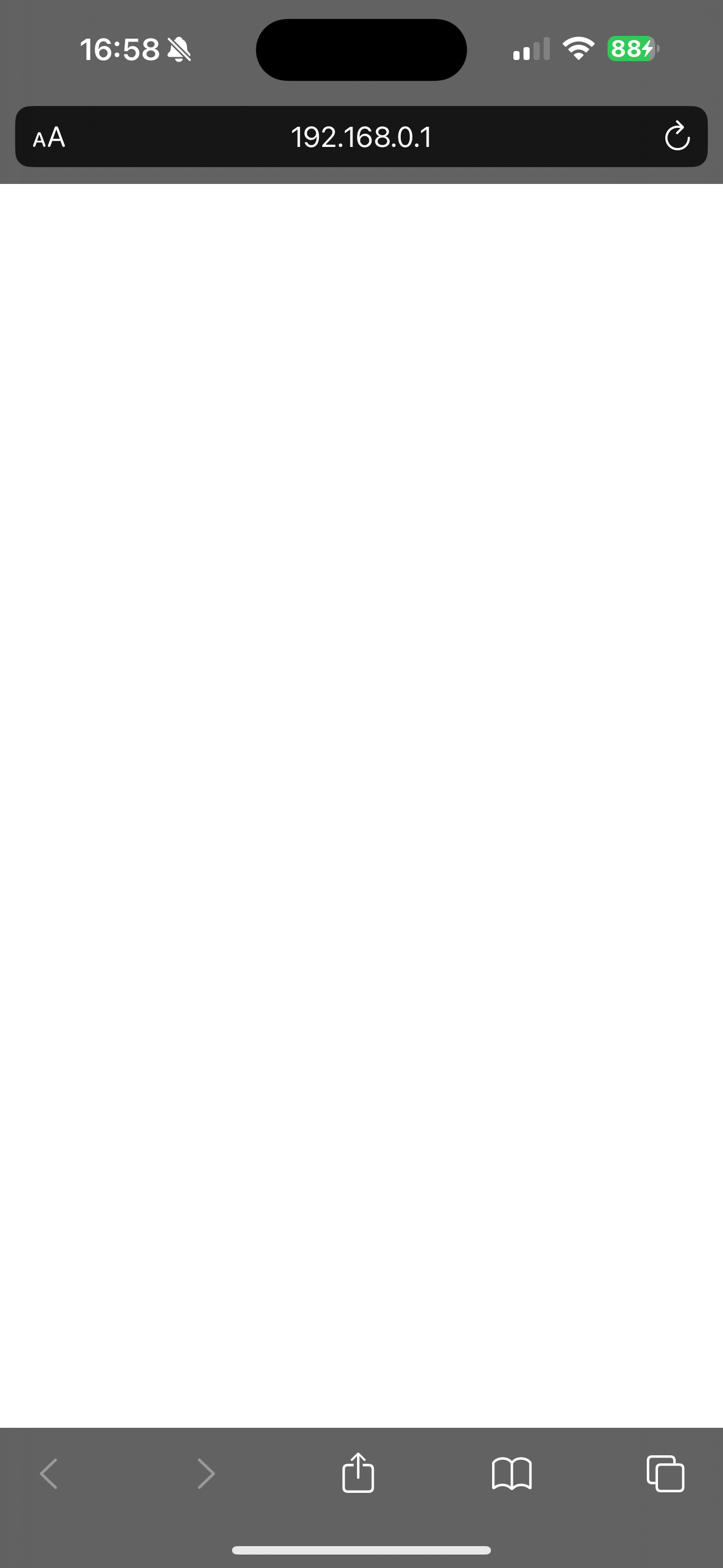

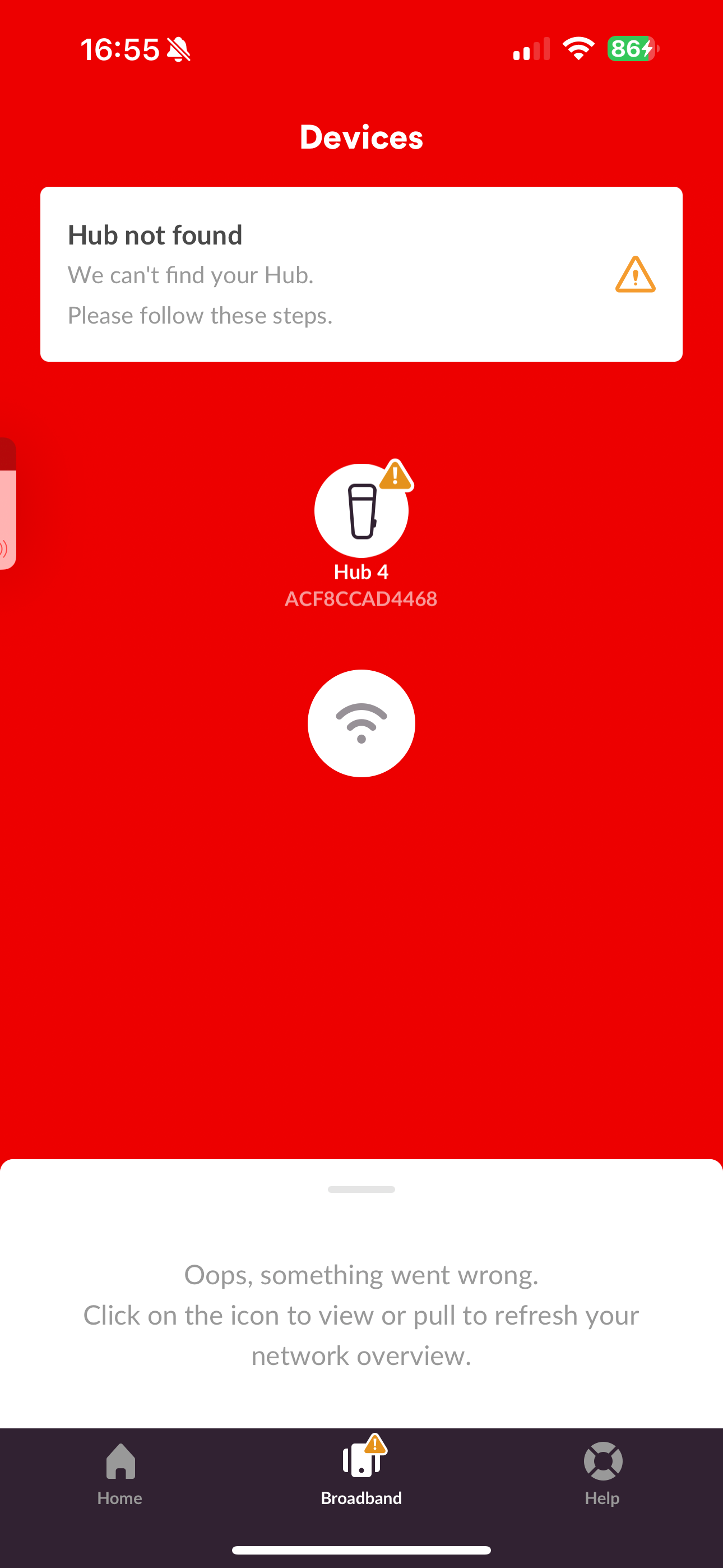

      I am also having this exact same issue with hub 4 and was on the phone for an hour then got hung up on! I have no connectivity to the app. Logging into the router via and Ethernet and laptop also brings me the same result as a blank white page sometimes it connects and the freezes and other times the page just hangs. I have held the reset button twice and left it an hour each time and still no luck it also keeps dropping my connectivity out. Anything else I can try? Also I cannot get on it to change my WiFi password back after the reset!
      I have included a photo of the app deleted it and re-downloaded it.
      And this is what I get when I try to connect to it over WiFi on 192.168.0.1.
    Try this.
    First, Uninstall the VM Connect app from all devices in your home.
    Press RESET on the Hub for a timed 60 seconds & then you must leave the Hub 4 powered on to revert to the shipping condition.
    Do not re-install the VM Connect app this is what is corrupting the Hub 4
    i.e. causing the Hub 4 admin menu to present as a blank screen & causing VM Pods to go offline.
    Manage the Hub via the menu at http://192.168.0.1/

      Thanks Client62! It worked just long enough for me to change my WiFi password. I never reinstalled the app either. @virgin is there a fix for this?
