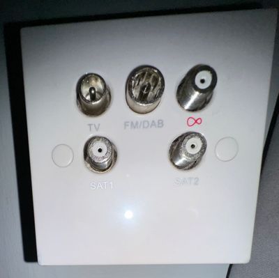

    I think goslow is onto something. In many MDUs the TV is supplied from rooftop-mounted aerials or satellite dishes with coaxial cables running to each unit via the IRS headend and riser patch panel and terminated at an IRS wall plate. When VM becomes a provider it brings its cable into the ground floor and up to riser patch panel. The customer's drop cable is repatched to VM’s incoming feed by disconnecting it from the panel's multiswitch and connecting it to VM’s own tap/splitter. VM then replaces the IRS wall plate with its own IRS wall plate. Here's a photo of such a plate.
    In other words no need to access the roof.

    We have seen IRS mentioned on here before as "integrated reception system" (a means of distributing AV/telecoms throughout flats via a centralised system of cables and faceplates) as below
