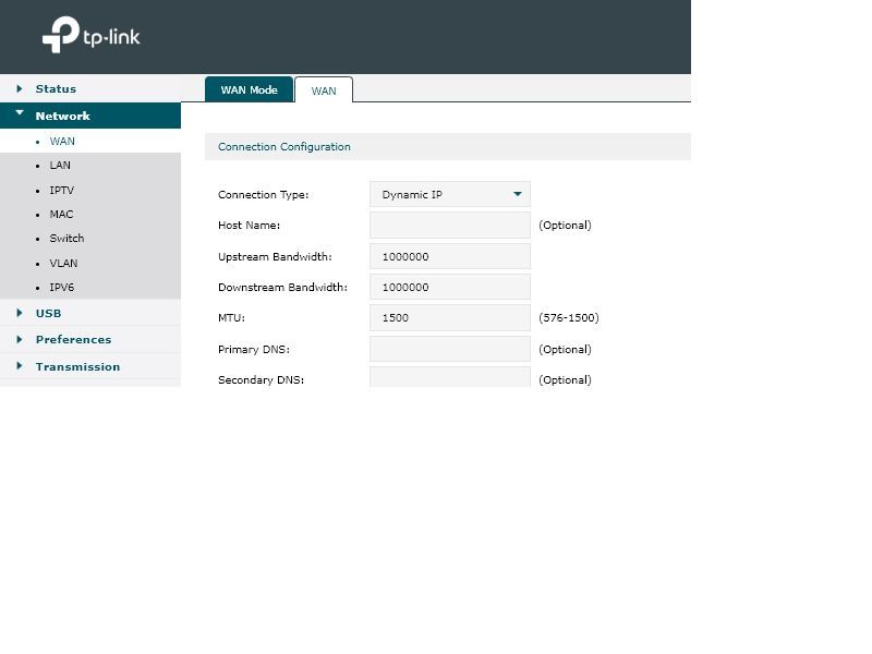

    In Modem mode there will be no DHCP from the Hub, as your ER605 will be doing all the routing. The Hub will just be bridging to the WAN.
    See inline replies and good advice from Tudor     ER605 WAN link should be as below screenshot from the TP-Link emulator

      Hi, sorry I am late to reply to this but I only just got my new ER605 and seem to be having similar issues. I have a superhub 3, which is in modem mode already. It works with my old (and unreliable, hence the change) D-Link Router but I wanted to replace it with an ER605. The image you posted shows I should be connecting to the router as Dynamic IP (which matches most of the info I have seen online) however it is unable to connect when I do that. I am not sure if I have a damaged unit or I am just not configuring it properly.
