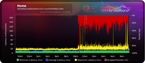

As of 10pm last night (and for a brief stint between 10pm and 1am the previous night) my upstream channels 2, 3 and 4 have crippled my connection with large amounts of T3 timeouts and lower than expected modulation (16-32 QAM vs expected 64). My downstream is fine achieving gig1 speeds as expected but my upload speed is down to half a megabit vs expected ~100mbps.
Below is my BQM chart for today.

        I did a pinhole reset only last night at about 11PM. All those T3 timeouts in the upstream channels are since then.
