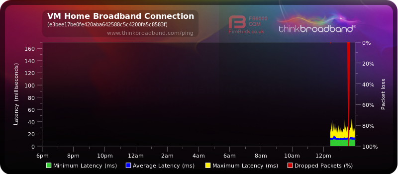

    Yet another upsell from VM to sort out a bad circuitโ€ฆ..  The 16 T3โ€™s are not good and would suggest noise on the line?  However the US Stats are not recording these, possibly due to the reboots. Setup a BQM to monitor and record these outages www.thinkbroadband.com/ping
    This will give evidence of the circuit failures.

      Hey Adduxi, thanks for your reply! ๐Ÿ˜Š
      I did have it embedded in my original reply but that reply disappeared and wasn't sure if the embedded graph was why.
      I'll embed it here:
      My Broadband Ping - VM Home Broadband Connection
      The big red bar was the most recent outage/reboot at around 13:40.
      Thanks again! ๐Ÿ˜Š
