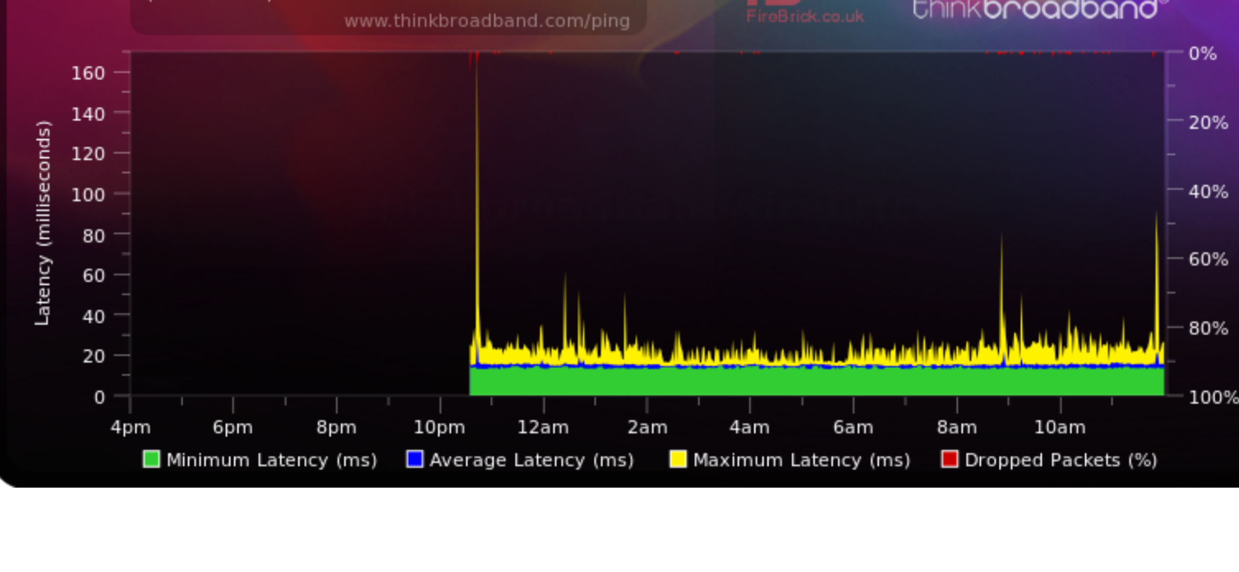

    Setup a BQM to monitor your circuit www.thinkbroadband.com/ping
    Once done we can comment.
