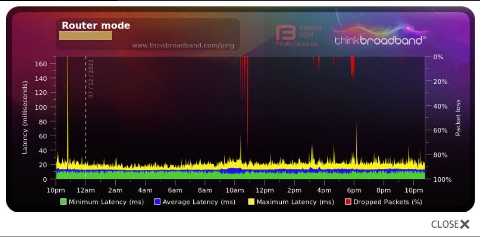

Hi
I'm on the 1 Gig service and although speed tests show the speed that i am paying for, I'm experiencing dropped packets which cause video calls to be dropped. An engineer recently visited to fix my landline and said the broadband signal levels look fine, but the stats on my Hub 5, look very unhealthy to me: huge numbers of uncorrected errors on the 3.1 channel (currently 2 billion errors showing!). Can someone help with this please?

        There had apparently been a miscommunication, as he thought he was coming to fix an issue with my phone line! But he listened to my explanation, and could see some frequencies coming through at very low power. He checked and found the underground amplifier that I was connected to was faulty (which i had guessed after reading this forum, and you may also have expected), so he swapped me to a spare tap on an adjacent amplifier that works fine. He confirmed everything is now in spec and I can see that in the stats on the hub, so I'm expecting it will be much more reliable.
        Thanks for your help, I'm quite impressed with how efficiently it got fixed via this route. It was so much easier than trying to explain the issue to one of your operators on the phone.
