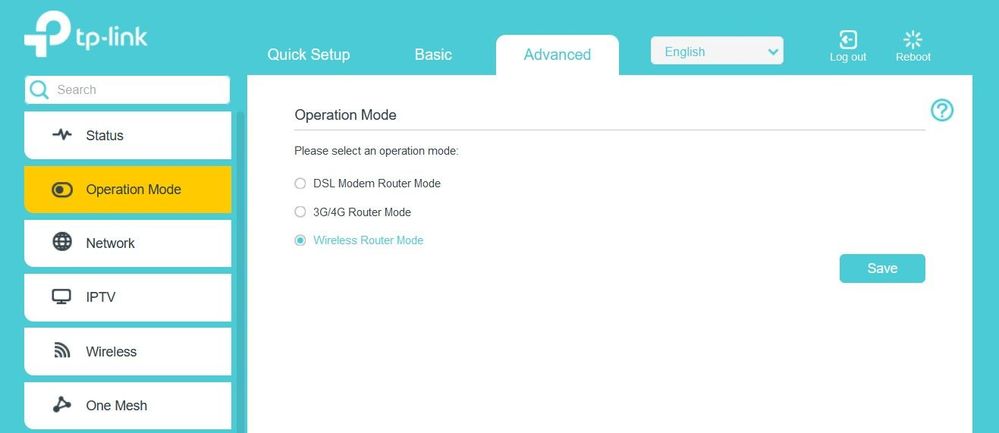

  3. I logged into my TP Link VR2100 settings and changed to Wireless Router Mode (See image1) using this guide (https://www.tp-link.com/en/support/faq/1731/). The router then rebooted.

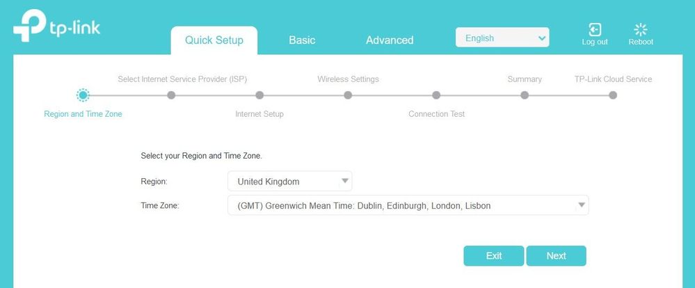

  4. I then clicked on TP Link Quick Setup and selected my region and timezone: UK and GMT. (See image2)

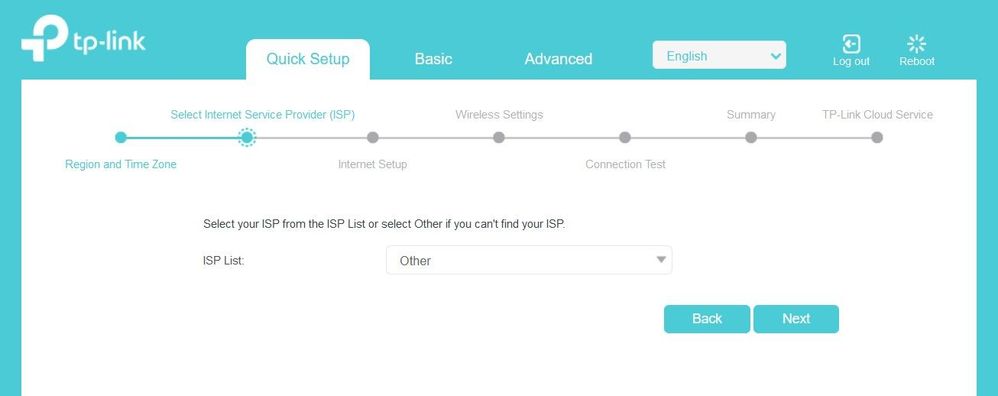

  5. I selected the ISP from the ISP list. The only option available was: Other (See image3)

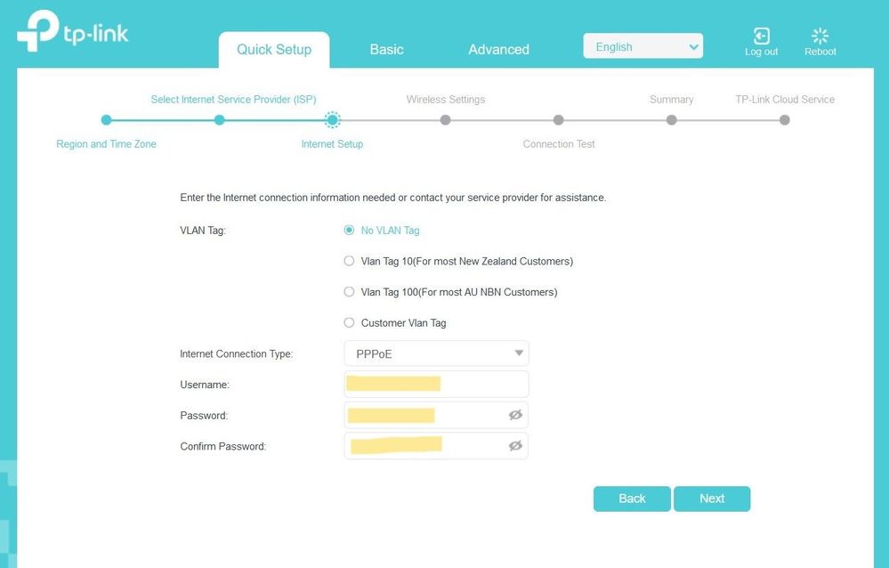

  6. On the Internet Setup I selected see below and image4:
VLAN Tag: No
Internet Connection Type: PPPoE
Username: I typed the Virgin Hubs SSID
Password: I typed the Virgin Hubs wifi password

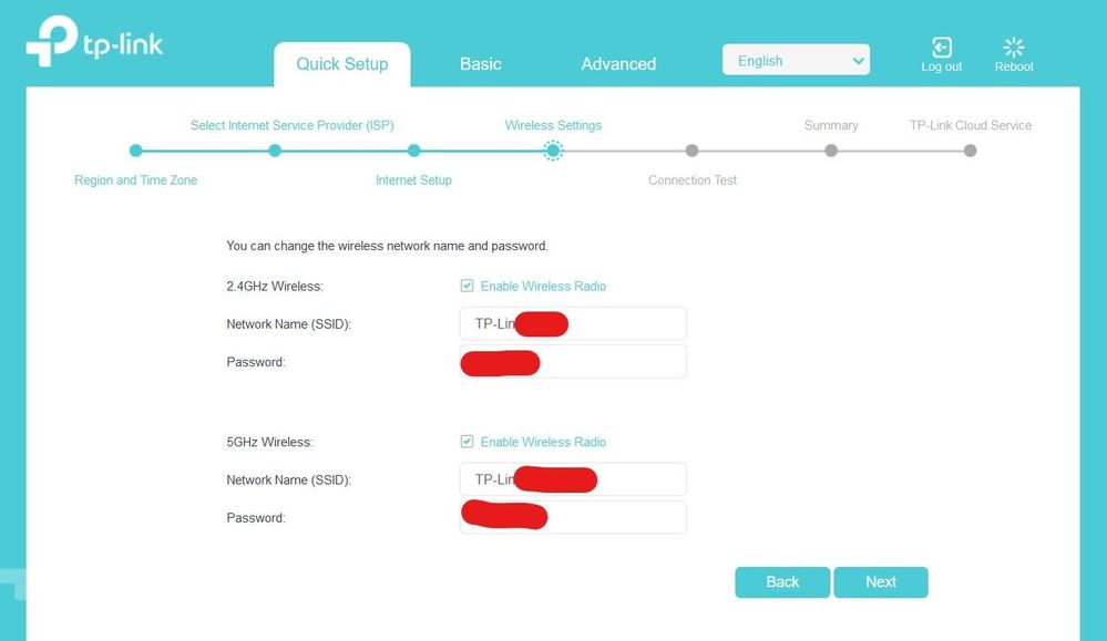

  1. I did not change the default Wireless Settings of the TP Link router. (See image5)

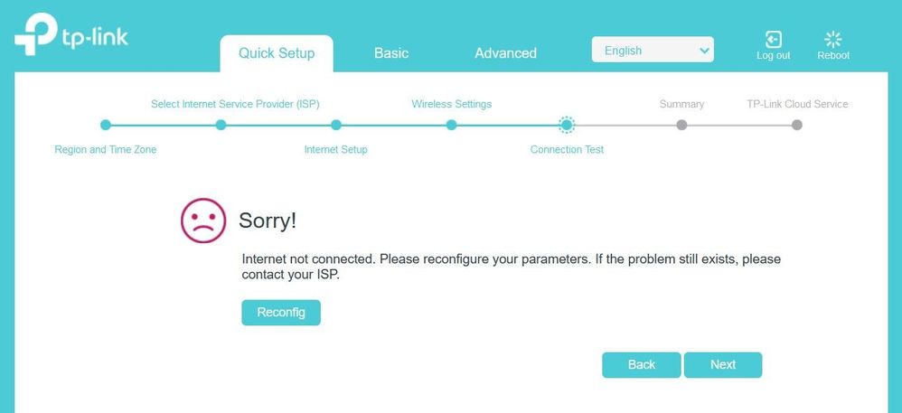

  2. Then it did a connection test, but it was unable to connect. It said ‘Sorry! Internet not connected. Please reconfigure your parameters. If the problem still exists, please contact your ISP.’ (See image6)

  • As legacy1 said.
    However I believe TP-Link calls it "Dynamic IP". Set it to Dynamic IP not PPPoE and you don't need any password.
