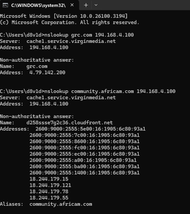

    it likely was DNS you can run nslookup in CMD to check like
    nslookup grc.com 194.168.4.100

      I'm not familiar with that command but just ran it on a site that was working fine a little while ago, but suddenly has lost all it's feeds!
      These are the same results as when I substitute 8.8.8.8

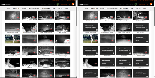

      The site has a page of still images, that refresh periodically, and seem to be loading ok. When you click on an image, it then should bring up the live feed, but these are now coming up 'Video unavailable'! However, when I check on my phone, using the phone's IP, they are working! 🤷🏻‍♂️ Also, just tried loading the site on a Chromebook and the same thing is happening!

      Further playing around....don't know if it gives any clues.... Loaded the site in an 'In Private' and 'Regular' at the same time.....the 'In Private' fully loads, the 'Regular' doesn't!

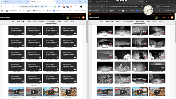

  • Just been trying to whittle this down.... In the past I was using Edge, but that is having issues now. (Though Edge on my Mac worked! 🤷🏻‍♂️ Tried Firefox and that wouldn't fully load the sites.
    Just tested Chrome and in a regular page I get the 'Video unavailable' messages, however, when I did an Incognito window, the sites loaded! Any clues there?
    Interestingly, while that was loaded, I thought I'd reopen the site in a 'regular' Chrome page and while it was trying to load, the 'incognito' page started buffering in each feed. As soon as the 'regular' page had gone to 'Video unavailable', the 'incognito' was back streaming properly.

      delete cookies
      • salamat's avatar
        salamat
        Dialled in
        Thank you so much! That seems to have solved it! Surely this can't have all been a coincidence with the changing of IP, can it? (I've been using that site for years, without the issue cropping up! )
