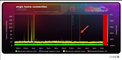

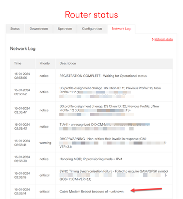

Hi
I noticed the last three nights when looking at my BQM's, they seems to be a loss of packets around 2am in the morning for the last three nights.  I checked the SH5 logs, and there are three entries saying the router re-booted.
Does the SH5 have a built in reboot timer, as nothing else in my house could cause it.  I even have the SH5 connected to a UPS, so has nothing to do with power loss.
This cannot be random, as it only happens once a day, all around the same time, in fact the first two were almost exactly 24 hours apart, to the second.

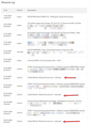

    Was just searching to see if there was a schedule, as only just had service installed (Gloucester Area).. but looks pretty darn close in time! so I would guess a rolling restart of sorts.
    11-01-2024 02:30:49criticalCable Modem Reboot because of - unknown
    10-01-2024 02:04:13criticalCable Modem Reboot because of - unknown
    09-01-2024 02:04:27criticalCable Modem Reboot because of - unknown

    It’s a Hub5 not a SuperHub and yes VM often carry out maintenance overnight which means your equipment looses contact with the CMTS. This does not normally cause a reboot, but perhaps there was also a firmware update.
