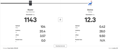

I'm on 1 Gig and for the last couple of days PC has slow to no internet access.  When I do a speed test (when it allows me to run it) I get around 8Mbps down and not even 0.5 up.   This happens when I use WiFi and Ethernet.

    Use the link below to check the service speed to the VM Hub and also the speed of your device.
    Once the test begins click on: Run full test to see all the stats.
    We are expecting to see the subscription speed delivered to the VM Hub,
    a large loss of speed at the VM Hub could be a fault in your street,
    check for that via 0800 561 0061.
    Do share a screen shot of the full test result.
    How is the desktop computer connected to the VM Hub ?
    E.g  Desktop to Hub cabled directly  or cabled via Powerline adaptors etc ...
