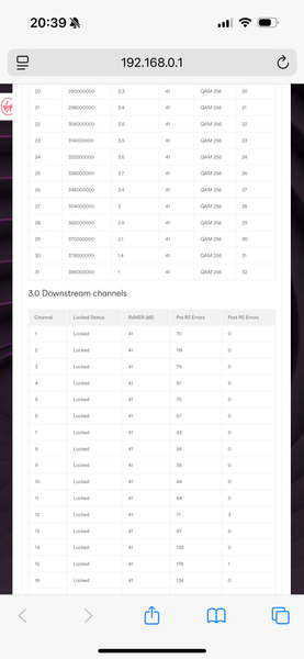

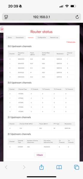

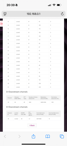

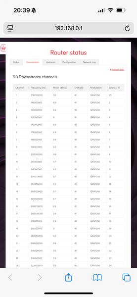

    ______________
    Post up your Hub/network connection details in the format below and someone will check to see if there is a problem there.  In your browser’s URL type in 192.168.0.1  if in router mode (or 192.168.100.1 if in modem mode).     No need to log in - just click on the “Router Status” icon/text at bottom-middle (Hub3/4/5) or top/right (SH’s) - of the Login page.
         Then… Navigate to these “data pages” and just copy/paste the normal  “Formatted Text” (not images) 3 FULL sets of data onto here – 2 tables from the Downstream, 2 from the Upstream, &  the Network Logs pages.  Don't worry too much about the formatting it can be easily read & DON’T include personal data or MAC addresses - blank them out - if you copy/paste the data, the board software will do this for you (you may need to click the "submit" button again). If character limits are “exceeded” - just do two posts

  • So I did a quality monitor which showed the below not sure how to read the chart as to wether its good or not. Will paste the network pages seperately
