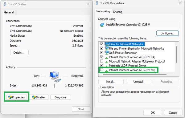

        That's IPv6.
        Try disabling IPv6 in the network card settings:
