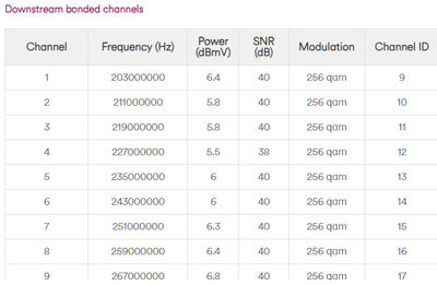

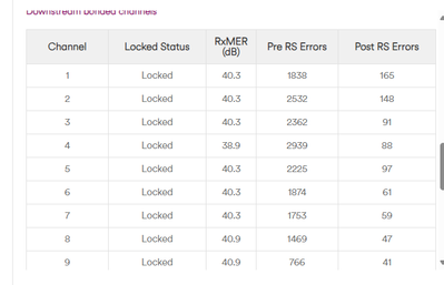

My current downstream power levels are 10db and above. I currently have a 4.5db splitter attached which has brought it down to around 6db.
Is it possible for VM to send me a 10db attenuator or are my current power levels fine and nothing to worry about ?

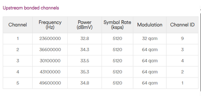

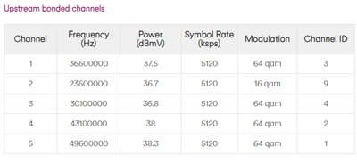

I have noticed that my upstream does drop back to QAM16.

    looks fine to me just your upstream is dropping modulation under 15db is fine for the downstream for the hubs

      Yeah upstream is the issue. Check for local faults on 0800 561 0061

      Apparently some works in my area are taking place, Problem has become worse today.
      Still the same problem. How does everything look fine on your end, Are you looking at a brick wall or something ?

        I have checked and can see there is an outage in your area that is due to be resolved currently today at 1.20pm. Are you able to let us know how things are looking after this time?
