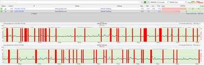

Pingplotter graphs showing what it's been like on shorter timescales:
