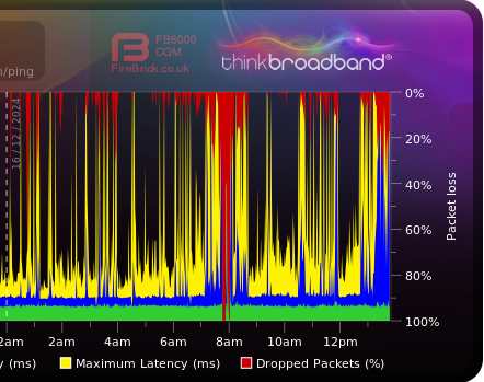

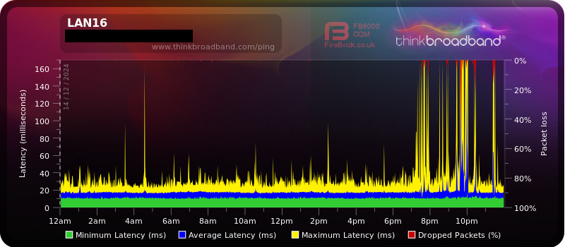

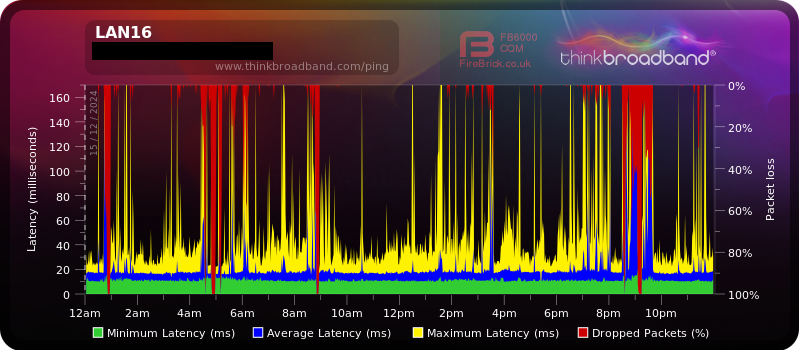

    VM hate intermittent faults their likely is a problem and even when it Docsis and logs show a problem it like “no more problem must of fixed it self” and happens on and off but there is a problem.
    you can setup a BQM to track when it happens

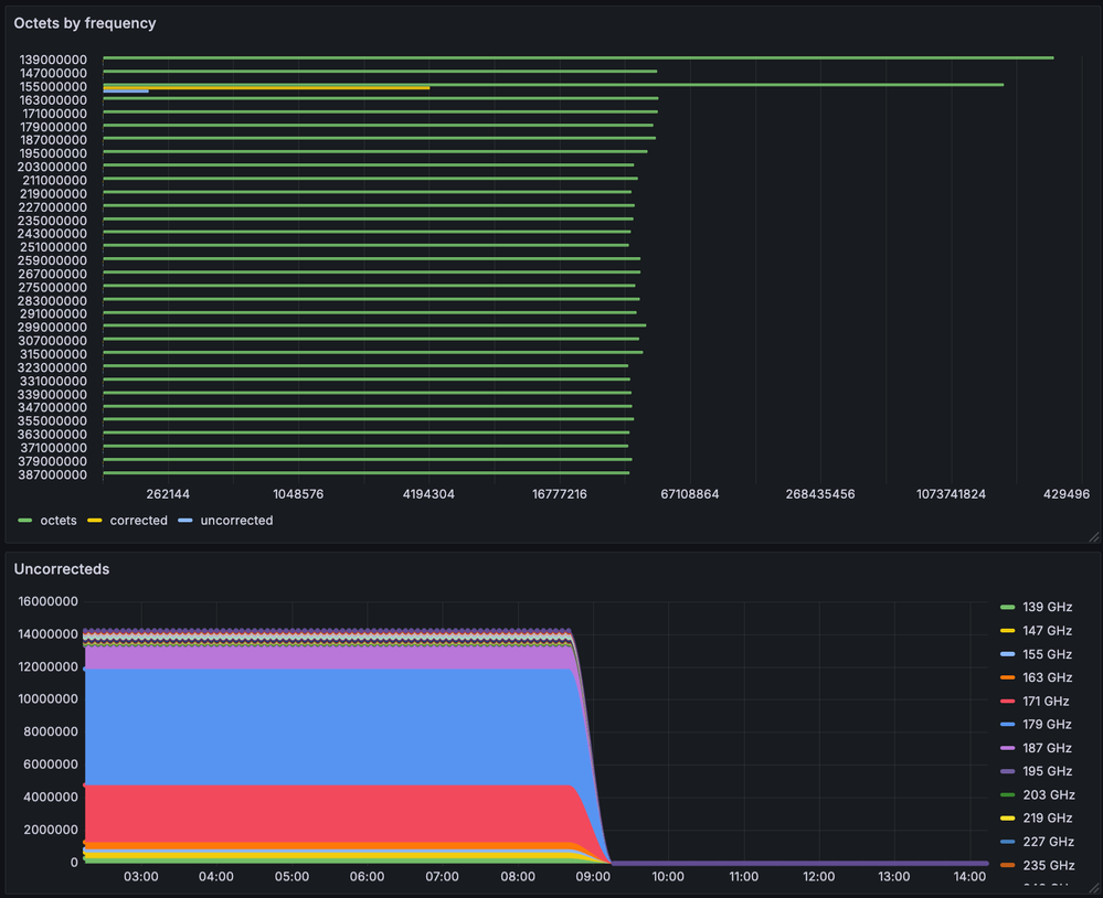

    Typically, this fixed itself without intervention late last week, but I kept the scheduled engineer visit.  He was excellent, confirmed that my modem/cabling/signal/etc was all good, but recognises the hallmarks of RF interference in the local area, based all the evidence I showed him (including Samknows drops, modem stats, packet loss patterns, etc), so has requested monitoring be put in place for some of the infrastructure upstream of where I am to hopefully nail down the cause next time around.
    This also spurred me to put in place my own monitoring to yank modem stats into Grafana so I can spot early signs of it happening again and get a case raised ASAFP.
    The (hacked, very) scripting is based on https://github.com/hairyhenderson/hitron_coda, with stats sent to InfluxDB for Grafana to display, something like this:
    The dropoff in the bottom graph is where the modem was rebooted this morning, clearing all the counters.
