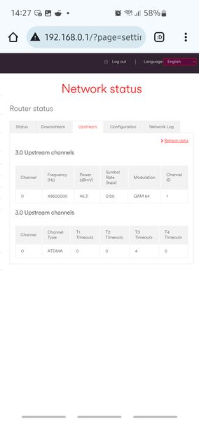

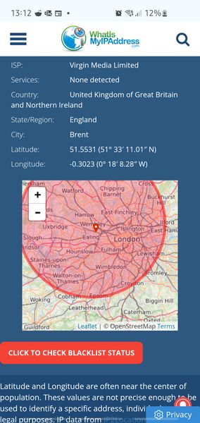

Today they done the update to my router and disaster my upstream has only 1 3.0 docsis channel no 3.1 upstream at all, IP address in 200 miles away again. downstream is ok so i thought here we go again ill just cancel contract as have time, rang vm eventually got through the incredibly long options process, and asked to speak with retention's she said it was but i think it was over seas as it sounded very low and far away you know when its not local, i record all phone calls so no lies can be told and she assured me i do not need o2 sim so ok fine lets proceed, she was nice regardless, but dont know the technical so she transferred me to what i can only describe as a crazy person i tried to describe the issue with upstream he asked about my tv service which i haven't had for years, while making this weird noise over and over again i asked him to stop as i could not understand him without the clicking noises he was making, i asked politely does he know what i am referring too he said yes but did not know what i was talking about, then it went silent and eventually he hung up, he was not technical.

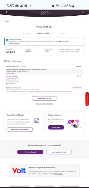

Another thing i noticed is my new contract offer was deceptively inaccurate, it stated on my account im currently paying £49 odd when im paying £44.44 after the rises so my new carry on contract was offered as £49 odd i wasnt being charged that, they offered cheaper without my phone line so took that off was assued it wouldnt effect my router is this the cause of my upsteam channel only having 1 docsis 3.0? many thanks. HELP PLEASE.

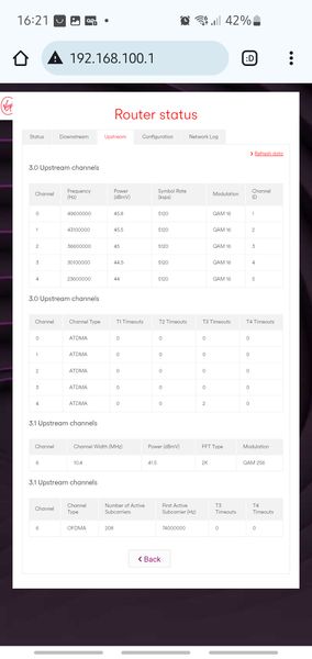

      Back up and running now but US modulations all at 16qam and have a violation for up stream power? Dynamic Range Window violation, it still doesn't let people upload stats?

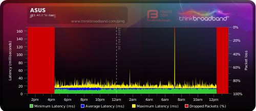

  • Anyone from vm any ideas? lost modulations on US (16QAM) constant packet loss all morning, dropout just after 7. Cheers

      You have an upstream noise issue and possibly power level issue on downstream bonded channels. Without seeing your stats, hard to confirm for latter. Sometimes this can be a faulty hub, it's usually connectors not tightly done up, a damaged cable or connector inside or outside the property. Thus is why you have intermittent loss of modem registration and obtain the correct channels.
      I'd ask VM for a tech visit if not an area issue as they can redo connections and fit an equaliser if power levels too strong. They can also escalate to networks if a cabinet issue or CTMS issue or request a cable pull if outside cable damaged (eg by rats or mice and water can get ingress).
