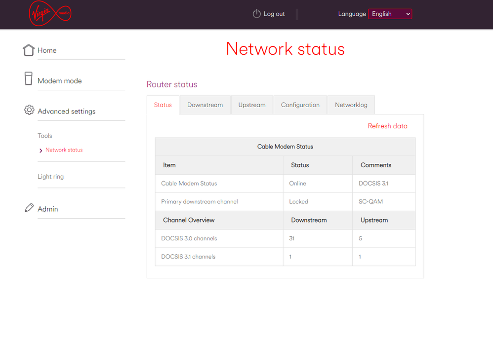

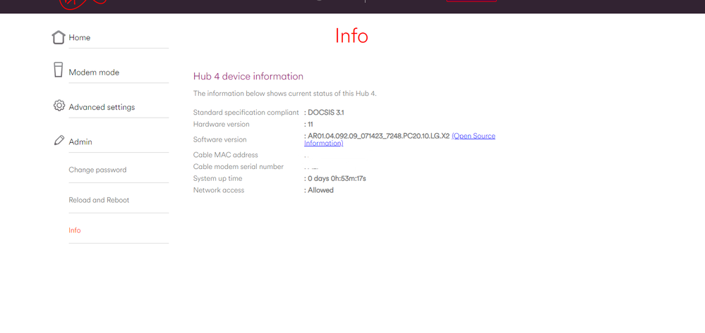

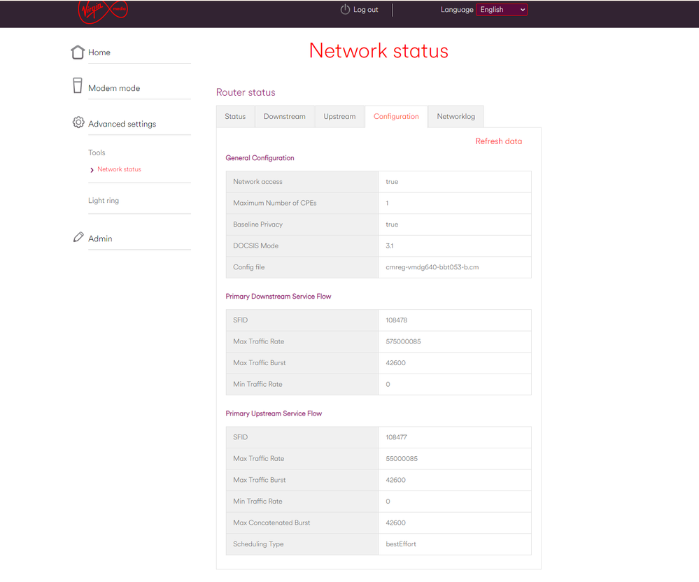

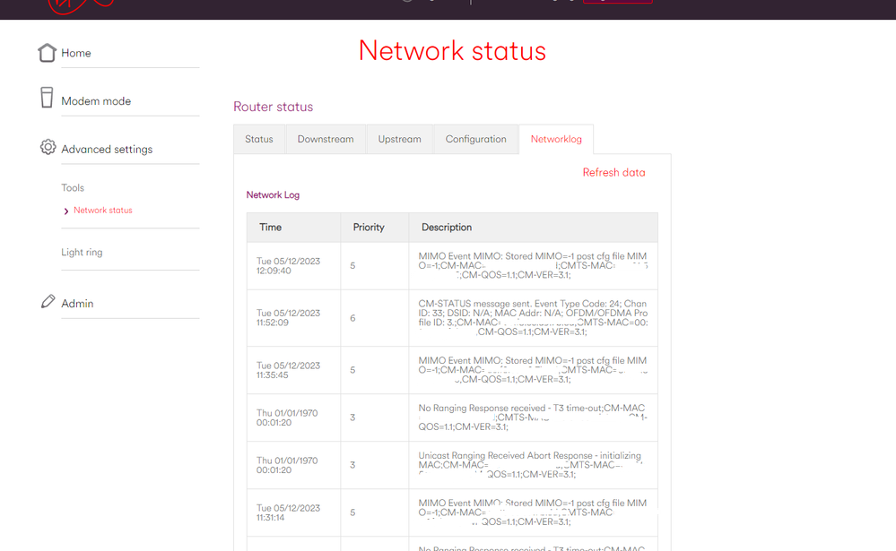

I manually set a static IP on the WAN port of the Netgear to 192.168.100.13/255.255.255.0 with default gateway as .1 - through this I COULD then connect to the UI for the Hub 4 (success!). However, not the internet... I took some screenshots of the admin page on the Hub 4 but nothing seemed to suggest an issue. Note in the last screenshot there's no IP/WAN information though when in router mode, on this page it does show a WAN connection status.
