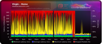

We've had ongoing issues since November with intermittent loss of service. I've had countless calls with Customer Support, who are all very pleasant but aside from endless hollow reassurances have proved unable to identify or resolve the issues.
If you're listening @moderators - we have had multiple engineer visits in the past month. Everything has been replaced: the hub 3; the cable inside the house; splitter and attenuators; a new cable from the road to our house. Signal levels have been confirmed good while the engineers were here. There have been mutliple factory resets of the hub 3. Have tried it in both modem mode and router mode. Despite repeatedly asking for the issues to be escalated, I see no ownership of the issue from customer support and have no confidence of a resolution. The only conclusion I can draw at the moment is any escalation processes that may exist are ineffectual and that Virgin are incapable of troubleshooting and diagnosing their own infrastructure.
Stats from the hub and BQM for yesterday, Feb 9th are as follows:

  • jpeg1's avatar
    jpeg1
    There is something intermittent in your connection.
    The downstream levels change, and there are always very high levels of noise on the lower frequency channels.  If the cables have all been replaced then the fault has to be further back, probably in the street cabinet.
    This is going to need more attention, from a technician who is qualified to work in that area.
  • Thanks - this is what I've been suggesting to Virgin for weeks now. Some neighbours have reported similar behaviour and an engineer came out to look at the cabinet this morning. He replaced pretty much everything, including the amplifier, which @legacy1 alluded to previously. It's looking much better now!
    • Beth_G's avatar
      Beth_G
      Hi Impudent
      Thanks for your screenshots of the BQM - it's been looking pretty awful up until around 10am.
      I've double checked this side and your downstream channels are out of specification - we'll need to arrange for an engineer to visit and tweak them.
      I've dropped you a PM so I can get this arranged for you.
      Thanks!
    • Beth_G's avatar
      Beth_G
      My apologies Impudent - looks like you're already chatting to my colleague Joe regarding this matter. I will leave you in his capable hands 😊
