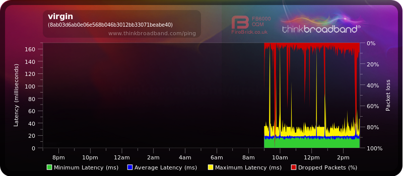

Hi, Right i'm a bit confused to whats gone off here so let me explain.
Ive been with Virgin Roughly 19 months im on the Gig1 package and the past 18 months ive never really had any issues or major/problems, never suffered from packet loss always been able to stream on twitch etc. I set up Thinkbroad.com graph up so i could see how stable line was and as i say ive never had any problems over the past 18 months always been perfect. as you will see in attached graph no packet loss: Graph
Recently my contract ran out so i renewed as i was really happy with how the connection as been, Then when streaming the other day and realised i was dropping frames in obs, so today i checked thinkbroadband.com but my graph was perectly fine as the above graph shows no packet loss, thats when i realised i now have a totally different ip address like im on a totally different connection? to what my previous ip/graph shows so the above graph is no longer showing my connection (strange) so i then setup a new thinkbroadband.com graph with this new ip adress i now have, and its just constant red packet loss as shows here in new graph here -: New Graph
Im really confused as to whats happened and why i'm no longer on the stable connection i was on in the first place ? and have been for 18 months with no problems.  Why as my connection been changed ? customer service say they need to send me a new router when this is not a hardware problem my line as been switched for no reason what so ever and the old graph is still live so that means someone else is on my old stable connection? and i've been changed to a unstable connection??
I currently cant stream at all and gaming etc is so frustraiting with constant packet loss i'm not happy to be honest cant understand why this would happen and no explaination!

      Ping statistics for 194.168.4.100:
      Packets: Sent = 200, Received = 185, Lost = 15 (7% loss),
      Approximate round trip times in milli-seconds:
      Minimum = 7ms, Maximum = 26ms, Average = 10ms
      Yeah im confused when i whois my old ip it shows as rotherham this new ip shows as sheffield so its definatly like im on a totally different line/connection or somthing im baffled and my connection is screwed as you can see in the new graph.

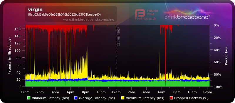

      • leenordon's avatar
        leenordon
        This as happened out of nowhere i noticed some dropped frames in obs other day when streaming but didnt think anything of it. Then today started streaming and instantly was dropping frames obs was in red thats when i checked thinkbroadband and realised the graph i was looking at is no longer the same as my current ip address. So setup a new graph with my current (RANDOM NEW) ip address i have now and as the graph i posted shows its messed up,
        I have already got a engineer coming out saturday and customer service say they sending me a new router and i will be given a new ip address wich will sort it out suposedly which i highly doubt the router is the problem ?
        I don't know why i would have to be switched to a different tap in the cabinet if everything was already perfectly fine in the first place, Does this meen i was moved to a different tap in the cabinet and thats why my ip changed and now a unstable connection ??

    • Kath_P's avatar
      Kath_P
      Hi leenordon,
      We're sorry to hear you've been having an issue with your services. On a residential service, the IP addresses can change from time to time and you're not always guaranteed to keep the same one.
      Checking things here, I can see the engineer visit was cancelled due to an area fault being raised. This has since been resolved and the team have already sent out a new hub. Once you receive this, please ensure it is installed within 5 days of it arriving. This will ensure there is no break in your connection then.
      Keep us posted on how things go and if you have any further issues, you know where we are.
        leenordon
        the line as been perfectly fine ever since so i dont need the new router that is coming and i want to send the new router back i want to stay on this line its very stable an di am happy can i send the new router back and just stay as i am please
