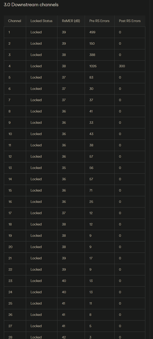

Hi
I logged my ongoing poor network performance issues (since installation) with support and I've not had any response to my emails chasing for updates. The status is just listed as "One of our team is looking into your issue." with my second submitted case status as below.
Maybe more than one of the team needs to look into it?
There was some maintenance in my area on the 10th which I'd vainly hoped might improve things but it hasn't. How do I escalate it (or obtain a response)?

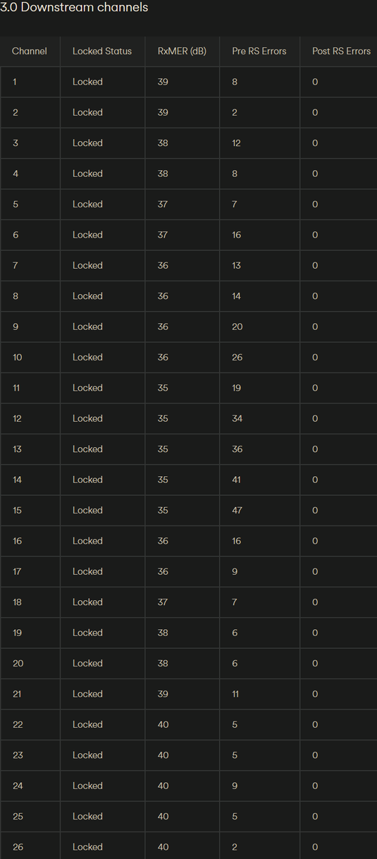

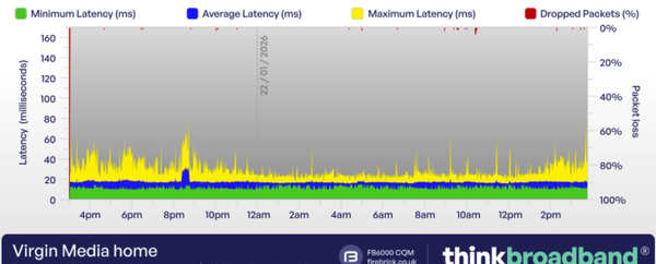

  • Hi tx for the reply.
    The engineer found an uncapped connection in the street cab and also swapped my hub for a v5. It's hard to diagnose with a speed test as the issue is intermittent. BQM's latency graphs look much better with no more significant spikes, but there seems to be occasional slight packet loss.
    The hub errors are as follows and appear to be stable, not increasing to the 100s or 1000s like before:
    There are only a couple of upstream T3 errors.
    The engineer didn't know BQM and was very distrustful of it, and convinced that my 16 port managed GigE switch and other home kit was affecting it!
    • gitty's avatar
      gitty
      Your new hub is DOCSIS 3.1, so you should now have an OFDMA channel (upstream). This channel is prioritized over the legacy channels. It may see less packet loss than the legacy channels.
      So the reason why you have less packet loss may be that the technician cleared up some noise, that you got a new upstream channel, or a mix of the two. :)
  • Tx for the info. I've noticed that the Pre RS errors have crept up again and I've had to disable pfSense DNS resolver's DNSSEC as I was having several site (Imperva CDN) lookups fail.
