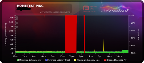

Having major issues with my VM 2G connection.

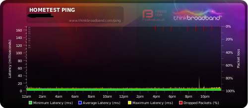

Large amounts of dropped packets (PIC1) and periods of complete downtime 2HR+s (PIC2). Which is making gaming impossible in the house, and WFH an issue as we need to be on Teams alot.

    Looking at PIC 1, what is the explanation of the two solid red bands,
    i.e. was there a total outage for two periods as the graph would suggest ?

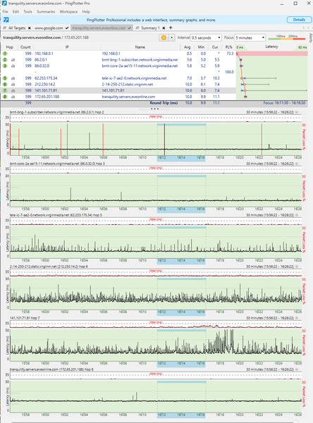

  • Not a network Engineer, but would this suggest that there is a local issue with VM with the packet loss occurring on HOP 2

      That loss is fine, between Brentford and Telehouse your data is encapsulated, nothing to reply to your traceroute.
      The speed tests they do every hour will be the cause of the hourly packet loss. This should be opt-in or at very least easy to opt-out but not surprising it isn't given the state of the XGSPON service with regards to the Hub, its software and the management platform Nexfibre/VM have.
      The total loss of service if no-one else is suffering they should get an engineer to you. If they insist on forcing hourly speedtests and no modem mode onto you the least they could do is monitor for larger scale outages.
