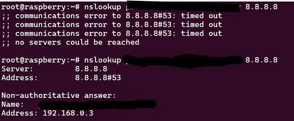

I also performed troubleshooting with nslookup and found the following:
On my network, queries to my server fail with:
communication error to 8.8.8.8#53: timed out no servers could be reached
This is unusual because the Hub 3 never caused issues like this. When I enable a VPN with local network access, nslookup works on the first attempt, and all reverse proxies function correctly.
Despite this, I still cannot access services via their URLs on the internal network, and services cannot communicate with each other using these URLs.
Screenshot of nslookup results: top shows queries over normal Wi-Fi (failing), bottom shows queries over Wi-Fi with VPN + local network access (succeeding).

      I do have network access on the machine, and I can reach external sites fine. However, I am unable to access my internal reverse proxy at 192.168.0.3 unless I enable a VPN and turn on local network access.
      I want to use the domain that points to the reverse proxy to access my services internally, but it seems that the Hub 5 is blocking connections to that internal IP when using the domain directly. The IP and gateway settings are correct (192.168.0.174 and 192.168.0.1), and DNS resolution works externally, so it looks like an internal routing or NAT issue on the Hub 5.

      Yes it is. 192.168.0.174 was my machines IP, 192.168.0.3 is the reverse proxy static IP. I can ping the proxy totally fine directly via the IP.
      However while on the network I am totally unable to access the reverse proxy or ping it via my domain im using. Once I switch to my other travel router or enable a vpn with local network access I can ping and access the services using the reverse proxy again totally fine.

    Likely the hub is doing rebinding protection odd that its doing it for 8.8.8.8 ... which it should not do.
