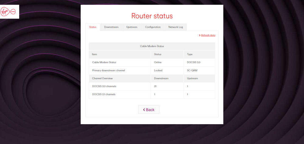

I have the HUB 5, and at the start of the year I had a lot of issues with my internet where my upstream channels were stuck at 1 (normally should be 5).

I've done a SamKnows test - things seem fine there, I've restarted the Hub, that hasn't helped. On the status log report, under Downstream I have 100,000s of pre/post RS errors

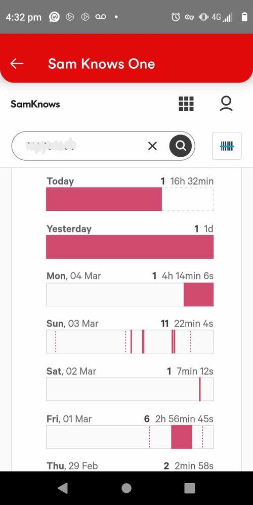

This is an older photo of my issues before.
