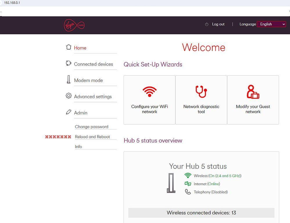

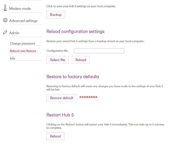

    Hi TOMSK65
    You can reset and/or factory reset your hub5 by logging in via the browser interface 192.168.0.1
    You need to select the restore to factory default option shown in the screenshots below. Restoring to factory default will mean any changes you have made to the settings of your Hub 5 will be lost.
